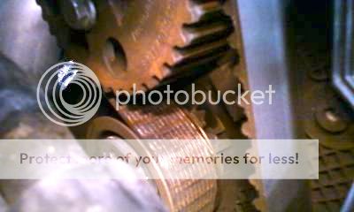

Merging on to the expressway today, I put my foot in it to blow past a D-bag that tried to close the gap I was shooting for once he saw my turn signal. Full boost and pulling hard it just shut down - no bang, no nothing. Didn't initially register it was actually dead and I though it might have gone into limp mode. Tried to restart, nothing. Coasted to the next exit and into the nearest parking lot, no start. No bad sounds, just no start. Called a tow truck and began to wait. Just for giggles tried to start it again and it fired up, sounding fine - hmmm. Canceled the tow truck and headed for my shop and tools, seemed to be running fine, boosting well sounding good. Got on the throttle a little again and it nearly died but stayed running, not sounding so good this time. Was really close so I limped it to my shop and started the diagnostic. VC came off, cam actually looked pretty good. Removed the IC pipe and TB cover and found this:
Sheared 21 teeth off the TB - really not good. I went home to make dinner for the kids, enough of that for tonight.
Before it is asked, yes it was a quality belt kit (Bora Parts) installed with the correct tools (Metalnerd) and procedure (Bentley "Repair" manual). Job went by the book both times with no question of perfection.
I will lock the crank at TDC tomorrow and see where the timing is sitting right now. I have no hope that there was no piston / valve contact, that seems too unlikely. I'm not that lucky.
