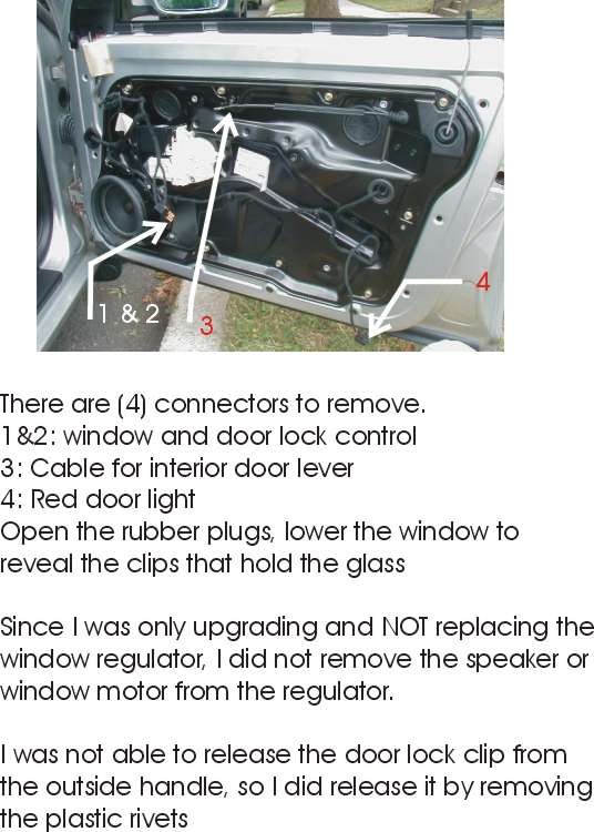

Ok,
First thanks to JSG for the written instructions. They helped out a bunch
Second, make sure you have a 8mm 12pt Triple point Serrated Wrench bit. I wasted time running around looking for one
Just like any project I seem to do, first lots of pics then as I get into the job, I seem to forget to take pics. So, I will amend these when we get to replacing Golfstream's regulator.
I did the passenger's side and will do my driver's side next.

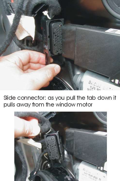

New Pictures and organized into THREE PDF's:
Door Panel Removal
Regulator Removal
New Clip Installation
