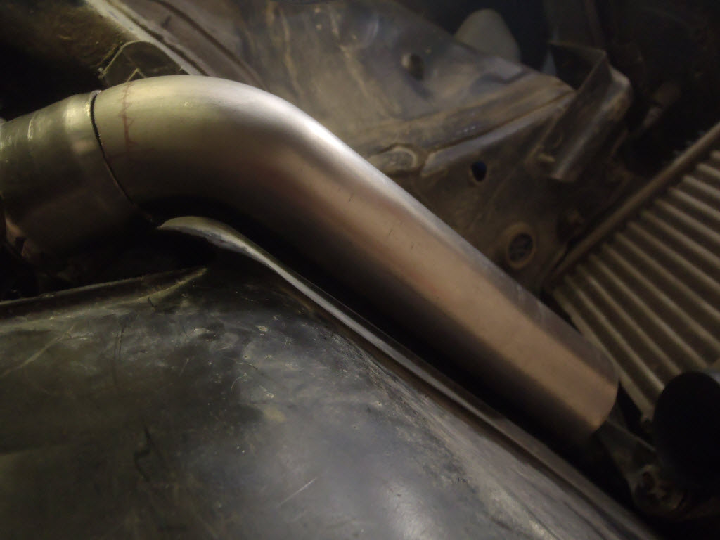

I cut the tube in the middle of the bend to get it to mate up with the hose adapter and run along the side skirt.
And then tacked it to the adapter
