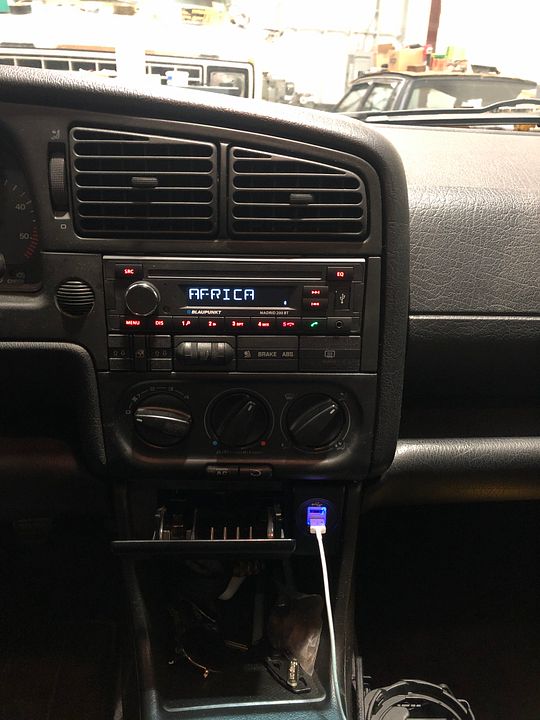

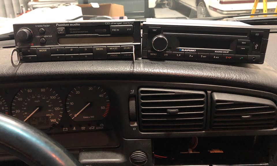

Installed a modern radio with a 90's aesthetic this evening. Used a Blaupunkt Madrid 200 series...it's probably 1/8 the weight of the original. It's nice to be able to make and receive calls without the use of earbuds and I now have 3 USB charge ports. There is a version that will accept CD's but not this one, nice and simple with an aux port and bluetooth.
I like this idea. But I want to find one that looks period correct and has the correct color display to match the cluster. You can change the color on some head units, but not on the Blaupunkts that I've seen.
Abacus
That helpful B4 guy
Nov 10, 2007
Relocated from Maine to Dewey, AZ
Only the B4V left
How is the sound? Almost every aftermarket radio I’ve found has really crappy and tinny sound, no matter what I try. I need a new one for the wagon, which I’ll be driving more after moving my daily driver back to Maine until late fall.

I didn't really do my homework on selecting this....saw it on a social media reel and decided to buy one since it had an aux port and USB and looked like it belonged in a B4 dash. I didn't know it had bluetooth and can pair with a cel phone at the time. Green display color would be great but it's not a deal breaker for me. I know some of the higher end Blaupunkts have illumination color that you can change and really dial it in exactly since you're adjusting various primary color amounts. This particular model the color is not adjustable as far as I know.
The sound is fine for me, I-red lacks rear speakers and has only the 4 up front. I listen to audiobooks and podcasts mostly so I barely notice the lack of kick. The headunit has a cheesy little equalizer which can switch between 4 different sound modulations: pop, rock, classic, flat or off. I keep it off since it sounds the best to my ear. My mechanical standards are high, but my electronic standards are low so I'm easy to please.

IIRC, I-red had functioning speakers in all 4 doors and the 2 on the dash. Likely original though.

I'm using one of these in my FL buggy for Bluetooth audio/phone connectivity. I like to stream music. The audio system in is integrated with the climate controls and would be a big $$ job to upgrade. Oddly, the car has hands free phone connectivity but no audio. As usual, I'm having picture posting issues :rolleyes:

Nice to see that it's officially broken in now at 300K mi. Nice to see it's getting proper care too just like I-red is in TDIDave's capable hands.
It looks like some of the Blaupunkts now have adjustable colors, at least the Frankfurt and Bremen now do.
e.g.:
COLOR (FARBE)
Setting options R (red), G (green), B (blue): create
your desired colour by changing the brightness
values of each colour (possible 16x 16x 16 colours,
each colour intensity can be changed by 16
increments).

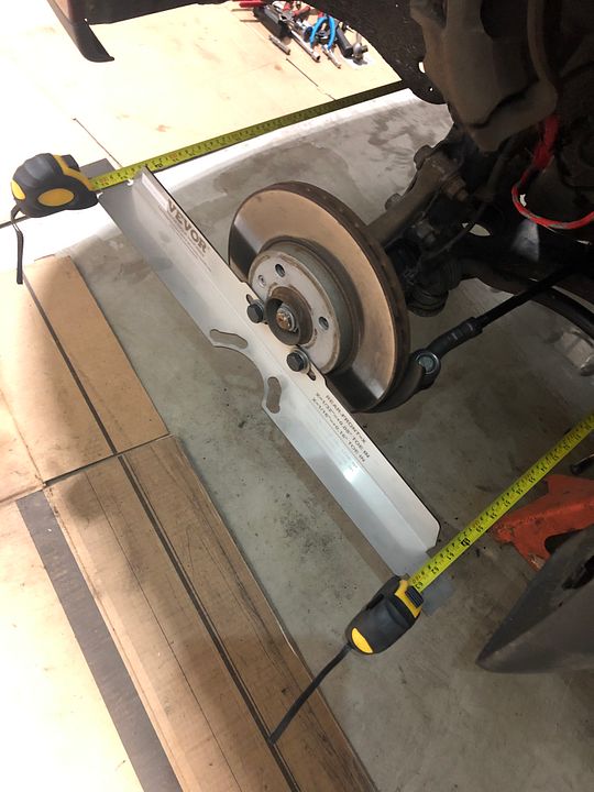

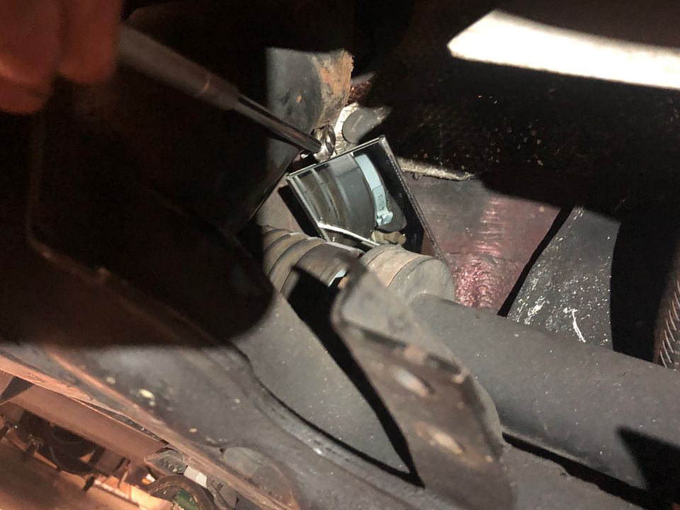

Needed to replace the right inner tie rod end so ended up doing them both along with new outers as well...since why not. I did the outer ends and boots about 10 months ago when the transaxle was out and the right inner showed no play. I was reminded how difficult it is to set the boots correctly and get the band crimped with the transmission in.

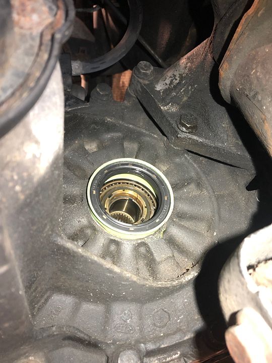

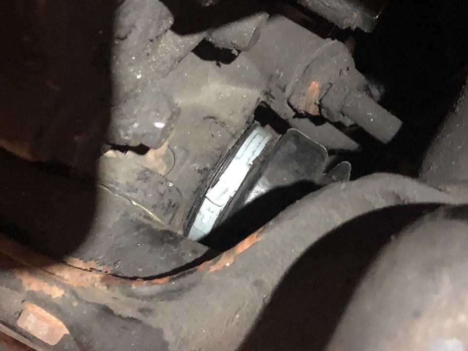

Left output seal was leaking so I did that, and it made access to the driver's steering boot a tad easier even though I crimp it from the side along the length of the tie rod but need the tool access for boot & clamp positioning.
Lined the toe up as close as I could get it, which was pretty damn close...It's nice not having to run a dedicated set of sacrificial tires waiting to get onto an alignment rack.
