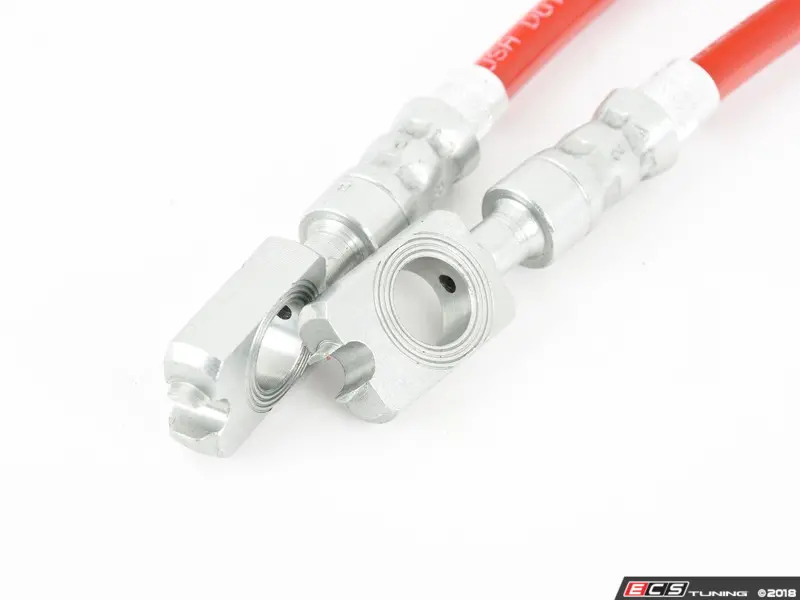

Finally installed my MkIV rear calipers and stainless steel rear brake lines. I got them from ECS tuning years ago. One of the brake line connections (banjo bolt) on the stainless steel rear brake lines would not seal. On closer inspection, the surface next to the copper sealing washer on the brake line was nicked. I had to file that out, sand and aneal the copper washers and was able to get it to seal. These brake lines have circular machined grooves to help the copper washer seal, but they don't work if there is a radial nick which is what this had. I'm not sure how I could have done that because I installed the copper washers and banjo bolt all at once. Machining on these brake lines is poor.
Picture of brake line banjo bolt area here:

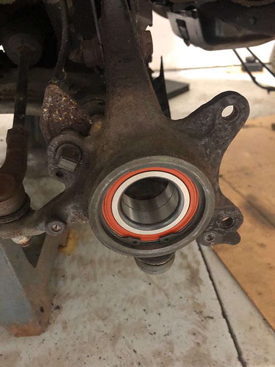

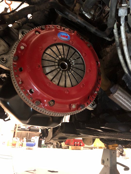

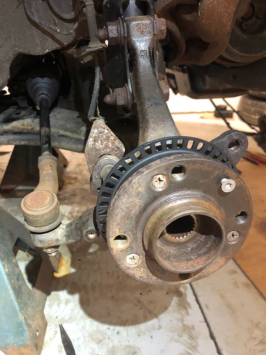

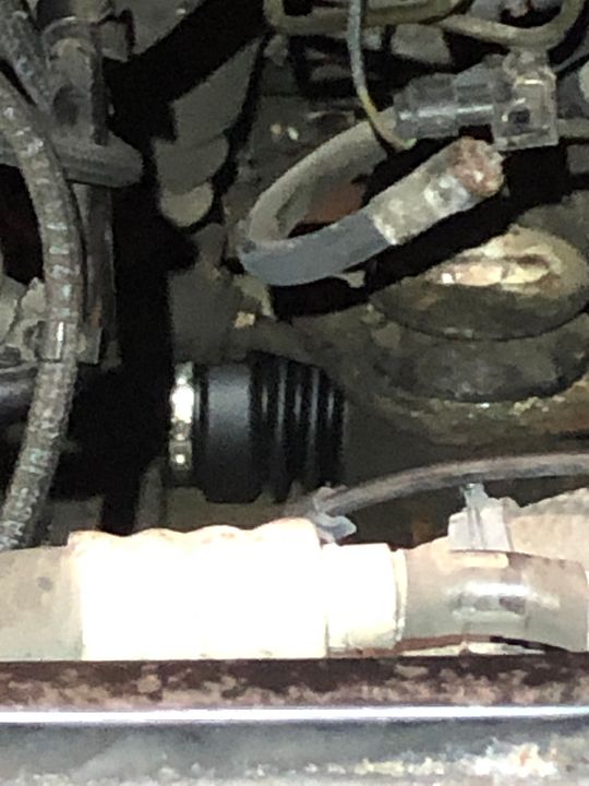

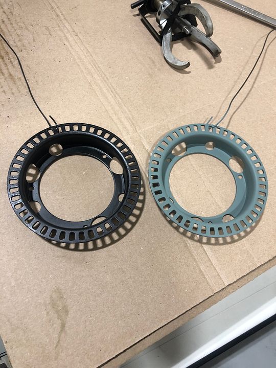

More progress on I-red to report: New SBC Stage 2 daily clutch installed, new steering rack boots, new oil pan gasket, both front wheel bearings replaced and both tone rings media blasted & painted since they were getting a bit crusty after almost 5 years off the road. Lastly in this repair session I put on new Zimmerman front rotors & pads, changed the engine oil and filled the transaxle with Redline MTL. The car is now back together and driving, as of tonight I have 650 miles on it...feels good to daily a B4 TDI after 4 years of hauling the mail with various Scooby cars. Instruments long dormant once again register life in the machine....and a piece of my soul has returned. I have a pretty good list going with everything else it needs to be "West coast ready" which I'll be getting to very shortly, not the least of which is figuring out where all the brake fluid is going. I have about 5-6 more repair sessions planned out but the clutch was the biggest most involved one.

Nice work Dave, it's great to hear that I-Red is back on the road. West coast will hopefully get it out of the rust belt.

Thanks, I've got lots more to address on I-Red. My daily scooby mobile was giving me extremely low power drivability problems so I had to get the clutch done fast and could not wait on axles to show up or upgrade the turbo drain line like I wanted since I had to get I-Red rolling. It's burning through a 1/2 liter of brake fluid a day, there is a leak below the master and it's leaking all over the new steering boot on that side. It'll all be fixed soon. I'm not moving..."west coast ready" is a state of mechanical confidence. I-Red will be off the road for the winter in a couple months.

Ah…. I have/had a set of hubs with those tone ring screw holes, and never knew what they were for. I never owned a B4 with ABS, so I was a bit stumped. Mystery solved….
