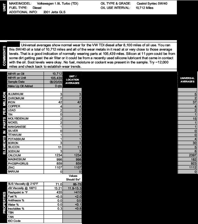

Macaco
Could not pull up you lab results with the link you posted. What year is your TDI and what were the iron, silicon, bearing metals, soot, and fuel values.
TornadoRed
Aug 3, 2003
West Des Moines (formerly St Paul)
2003 Golf GLS 5-spd, indigo blue; 2003 Jetta TDI wagon, silver; 2003 Jetta TDI wagon, indigo blue; 2003 Golf GL 5-spd, red (retired); 2003 Jetta TDI wagon, Candy White (sold)
Macaco: the numbers all look normal. What is the oil history for this engine? Has it always been run with Syntec?
Macaco
Active member
Dec 23, 2007
Brooksville, Florida
Jetta TDI GLS 2001
I bought the car when it had 66K, so no idea what was before but on my time YES always the SYNTEC.

Macaco,
Since this isn't a PD engine, I think you could lower these wear rates by perhaps 1/3 by using a slightly heavier, API/CJ-4 spec diesel oil (Delvac 1/TDT, Amsoil/DEO, Rotella T synthetic, etc)
TS

TS: Castrol Syntec 5w40 has a viscosity of 14.0 centistokes at 100°C.
Mobil 1 ESP Formula M 5w40 has a viscosity of 13.35 cSt, for Mobil 1 Turbo Diesel Truck 5w40 it is 14.9 cSt.
So ESP Formula M is in the lower part of the 40-weight range, TDT in the upper part, and Castrol Syntec in between.
I agree with you that there are better oils than Castrol Syntec. But will it make any difference in Macaco's engine? Probably not. His engine is doing okay with Syntec, and switching will probably not prolong its life. I doubt that he will look back, after his TDI rolls past the 700k-mile market on the odometer, and say to himself, "Gee I wish I'd switched to a different oil way back when."
Syntec is not the best oil for TDIs, but it is not killing TDIs either.
