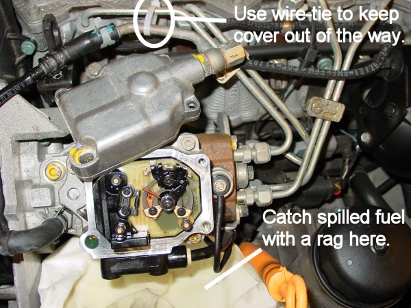

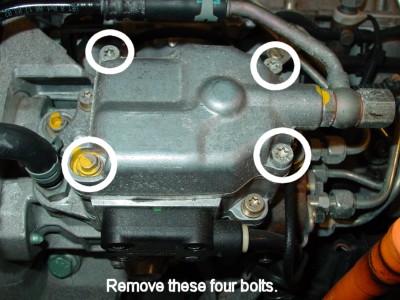

After removing the engine cover, you'll need to remove the injection pump cover. FIRST, place a wad of rags in front of the injection pump to catch the diesel fuel that spills out. These bolts are not very tight... even a 1/4" ratchet will remove them easily. Use a TX30 bit to remove three of the bolts. Use a 13mm socket on the DieselGeek adapter to remove the triangle bolt. Now the top will remove, and some fuel will spill out.
Use a wire-tie to secure the cover and keep it out of the way. I used a clean rag to soak up some of the diesel fuel around the sensor. Note the position of the sensor. It looks like it could be installed upside-down, which may or may not affect it's operation.
Use a TX10 bit to remove the two screws holding the sensor. This could easily be done with a nut driver, as they are not especially tight. Remove the sensor, then follow the instructions in reverse to finish the job. Use a clean rag to wipe off the mating surface between the cover and the body of the injection pump.
