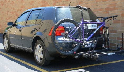

most of my driving is around Roanoke City / County and mountain backroads. i shift at anywhere from 1800 to 4200 rpms. lately i've been trying to shift for economy (~2k) but i P2F accelorate past 4k rpms in 2nd and 3rd at least once daily (cleansing + fun :D).
additionally, my TDI is loaded a lot. my hidden hitch is hyper active - either a bike rack is attached or i'm towing my 5x8 utility trailer and have the roof rack on with a canoe or other gear on top. i definitely do not fall into a "light" use category.
this is what she looked like last weekend...
and here she is in the parking lot moments ago with just my beloved RIG 29er single speed...
i have an air lift kit installed that keeps the rear end nice and high when loaded - notice the clearance above my new Nokian i3s in the back.
AWESOME. Your first 29er? I've been debating going that route. I've been riding SS for quite a while, and full rigid for the last year or so (which gets even more comments than riding SS... go figure). I've only seen one 29er in these parts, so not much local feedback.
