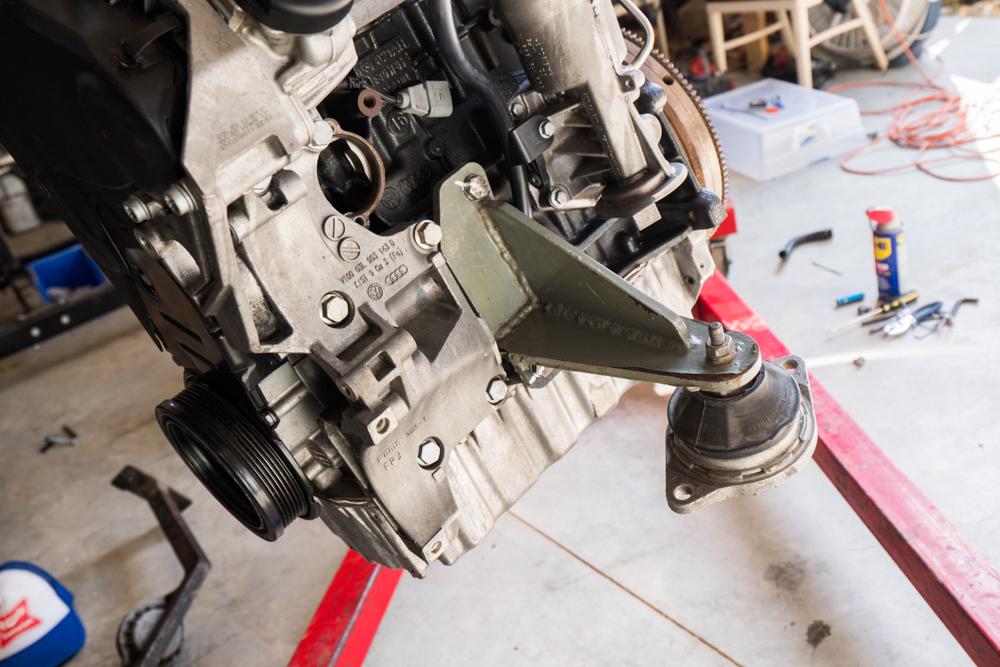

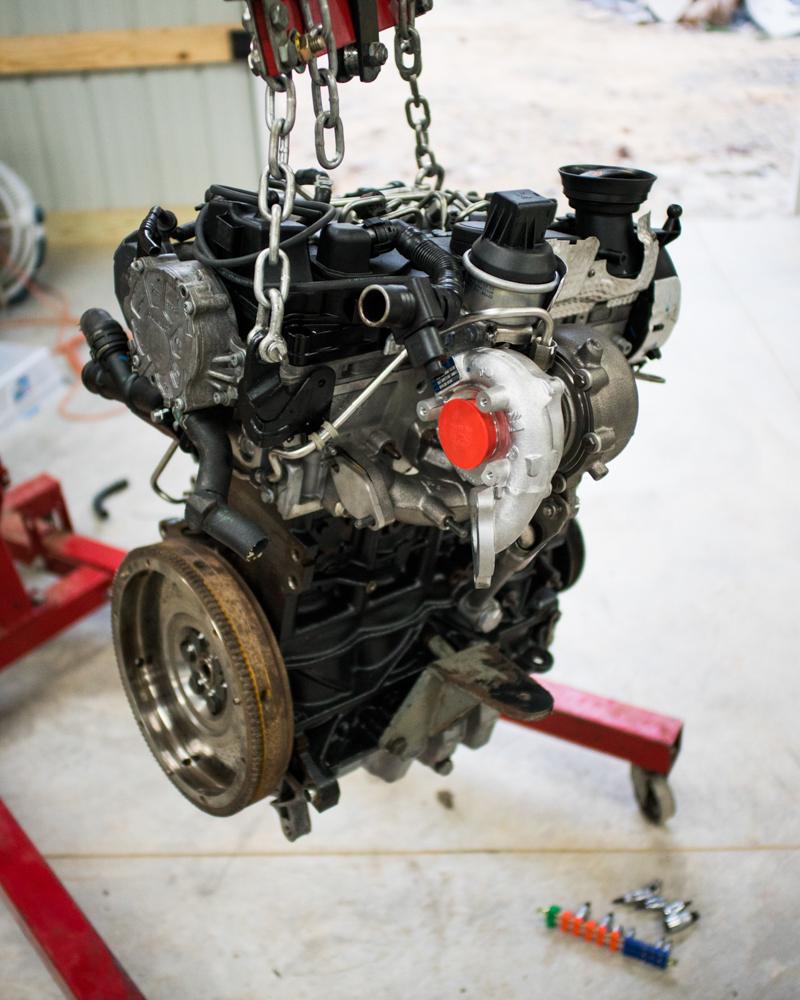

So I shipped Otis (my van) over to Greg’s shop / 100 acre-syncro-playground just outside of Nashville and over the last few days we’ve dressed the engine with a brand new wiring harness (by Greg), new turbo, new clutch, sensors, etc. The way he has it, it’s actually pretty minimal when it comes to electronics, making it seem like a cool halfstep between an etdi and an mtdi, but with a commonrail fuel delivery system.
He also has it setup so that the user can switch between customizable power modes at the dash, ranging anywhere from 100hp on the low end and 240hp on the high end. SO, if I’m stuck in the sand or in the mud and my wheels are just spinning, I’ll be able to pop it into a higher power mode to help get out.
The CR block has the same mounting positions as the PD, so we’ll be reusing my old (15 degree) PD mounts, making the install that much easier.
