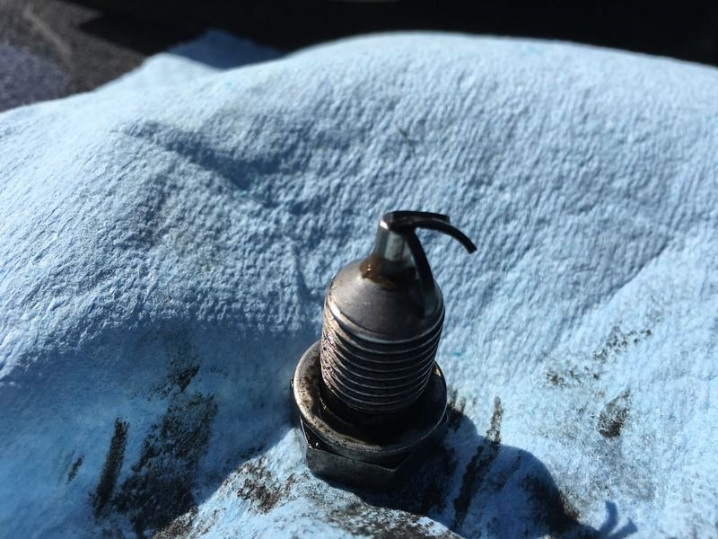

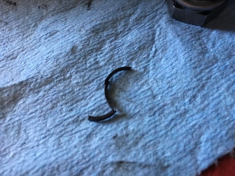

I am changing the oil in my 2003 Jetta. She has 272k miles. I try to change it every 10k but I am off by about 2k this time around. Anyway, when I pulled the plug I found some metal attached to it. It is a magnetic style plug, but I never imagined I would capture anything like this. Can someone please help me identify what these came from? It might be hard to tell but they are curved and almost seem to have a lip on them. Unfortunately when I took everything back outside after taking pictures the wind blew the towel I had them in and now they are gone.

I do not think they are bits of a seal, but I could be wrong.
If these are bits of a seal then why would it be disintegrating? I have never had this engine apart for any reason other than to do timing belt changes, thermostat changes, and starter change. I have never been inside this engine.

How thick are they? My first thought honestly was bearings, but, I doubt it.
You might consider pulling the oil pan and inspecting what you can find there. See if there's anything else in there.
The shape and their being metal is why I said it looks like the remainder of a seal. If you're not the original owner, the previous owner may not have gotten all of the old one out somehow.

I have owned it since 85k. I doubt any work was done previous. The thickness on them starts off at nearly nothing and gets up to maybe 1/16". I still need to tear the filter apart to see if there is anything there too. It is just too hot right now not having a shop or garage to keep it in.

When I pulled my head recently, I removed the turbo oil feed line (because I destroyed the other end at the turbo) and found similar debris stuck in the banjo bolt at the base of the oil filter housing. I think it was three pieces just like your pics. I thought mine were plastic, but I didn't check with a magnet. My only thought was I was glad the pieces didn't make it to the turbo bearing. They seemed to make a circle. I was thinking plastic bits from an oil filter...
315K on my 2002 wagon. I've owned it since 220K, and I have no history on it, so I didn't overthink it. Just put the head back on with a new oil feed line and kept driving. That doesn't mean that there wasn't some event in the past that I don't know about.

not the thrust bearing pictured but most likely the exhaust side or compressor side piston ring ... thrust is on the cold side and typically just wears into fine particles ... as Genesis stated above, driving the car now is like winding on a jack in the box ;)
