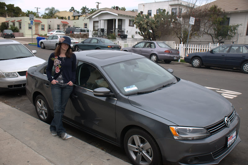

Hi,
I got my TDI last Tuesday and I love it so far.
2011 Jetta TDI w/ Nav Manual

Any bigger pic? I still can't find one in grey with the chrome trim to look at. I am trying to decide between your color and the silver.
Congrats, did you get the auto or manual?

I got the manual. I think the Platinum grey looks cooler. I test drove a DSG but i felt I got more power with the manual.

Very sharp! Hope you have many trouble-free miles. Fuel up with a 2% biodiesel blend whenever you can.

Thanks for the bigger pic. Looks Great!
You thoughts confirm what I thought about the manual. I think I will go with the manual.
