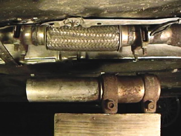

Matt, do a search for "flex pipe" in the forums. The addition of a flexpipe on the B4 Passat should fix your problem.

B4 Passat diesels ALL have a problem (eventually) with resonance and noise from the exhaust system. I don't think anyone has pinpointed the exact cause but there are quite a number of different solutions (including the extra flex pipe behind the catalyst mentioned above).
My solution was replacing the whole thing with a 2.5" straight pipe ...
