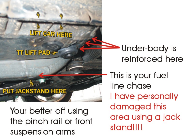

Not a problem with me either. Here is a pic I stole from the VOrtex. But is shows where the reinforcements are.
I don't agree with using the fuel line chase to put a jack stand.
