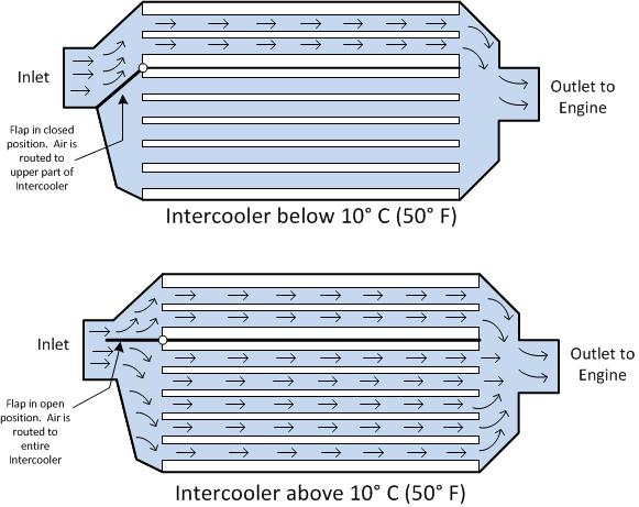

so the vacuum valve is controlled by the ECU which is based on temperature and actuates a moving part inside the intercooler which blocks off a portion of the internal volume?

..... so the vacuum valve is controlled by the ECU which is based on temperature and actuates a moving part inside the intercooler which blocks off a portion of the internal volume?
My guess is that it's operation is much simpler than having the ECU involved and only relies on an added thermostatic valve to apply vacuum below a certain temperature to actuate a flap which closes off a portion of the modified intercooler.

I haven't seen any decrease in FE, we drove the car in 32*f to 35*f temps on the highway for three hours (erie pa to rochester ny) a few weeks ago, and got 42mpg which is bang on for winter with our car. This was with the lower IC grille unblocked - I run a grille block around 35*f and under, search for idparts grille block, or make your own out of foam pipe insulation, helps heat the car up and *helps* prevent icing.
Here is a nice diagram courtesy of RES. http://pics.tdiclub.com/data/500/Intercooler10.jpg

I just had this installed last week as well. Have not noticed any decrease in FE, but the time span has been to little to notice any change. Temps this week are frigid as well.
If the flap were to fail in the closed position, would cause a check engine light/code?
