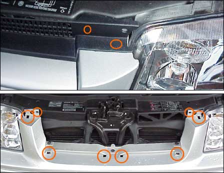

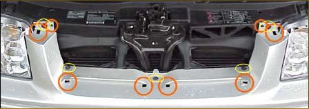

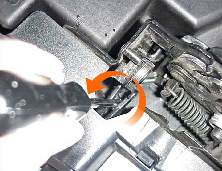

Remove the grill. The grill is held on its corners by hooks that snap into the bumper cover. The hooks go where the orange circles indicate in the following picture.
Lifting the edge of the grill will allow you to unsnap it and pull the top towards you. Don't pull too far as you still have to disconnect the hood release handle; like so:
Once the hood release handle is removed you can pull off the grill .
Now proceed to remove the bumper. The Jetta bumper is held by 4 T25 torx screws inside the frt edge of each fender well. (Don't forget to remove the side markers! Push in on the frt edge until it goes into the bumper and pull the rear edge off. No need to pry!)
5 T30 torx bolts are located underneath the grill.
2 T30 torx bolts inside the bumper air intakes. Sorry no picture. To take the plastic intake covers off just pinch on the two slots on each end. You'll figure it out! /images/graemlins/laugh.gif
Once all the bumper bolts are off you can pull the bumper to the frt and off. Make sure to place it on something soft, especially the pointed corners at the rear, to avoid scratching the paint. Don't ask how I know this... /images/graemlins/rolleyes.gif

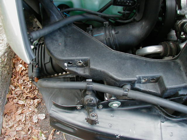

You should now have this staring at you:

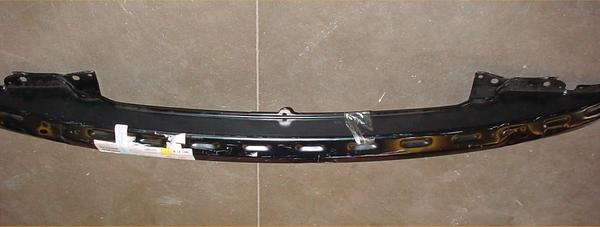

Now we come to the biggest headache. I have confirmed that you do need a euro rebar, (even if you have a wagon), unless you can get a used one from a US MY2001 Jetta wagon. (I have a 2003 wagon and it has the same rebar as the sedan.. Made in Mexico no less!) The Euro Rebar is needed to mount the washer assemblies.
Correct Part Number for the Euro Rebar = 1J0 805 551 <font color="red">E</font>
NOTE: It seems that the VW warehouse has the C rebar, (US), as the replacement for the E euro rebar in their computer and it doesn't matter what number you order you will be getting the C if you are in the US.
John at IMPEX will be trying to get some of the correct ones from Germany but it might take awhile. If you are interested let IMPEX know that you want the E rebar with the headlight washer mounts because if you order it from the web form it will default to what VW says and you will receive the wrong one! (Don't ask me how I know this..) /images/graemlins/mad.gif
You DO NOT need the Euro bumper cover for the Jetta/Bora. The front bumper covers are almost identical. The only difference is that the euro bumper cover has a set of dimples on the inside face to help guide where you need to cut the hole for the nozzles. The US bumper does not have the dimples. (Unless you have a wagon like mine, (made in Germany), that contrary to popular believe DID have the dimples!).
ETKA actually tells you that if you need the euro cover for a car with headlight washers it will need to be shop modified, hence the dimples.

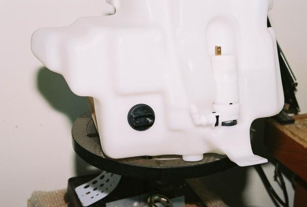

Prepare the new tank.
Install the filter in the neck and cap;
Install the headlight washer pump with the new grommet from the kit in the frt hole of the bottle;
Install the old pump using the old grommet in the back hole of the bottle;

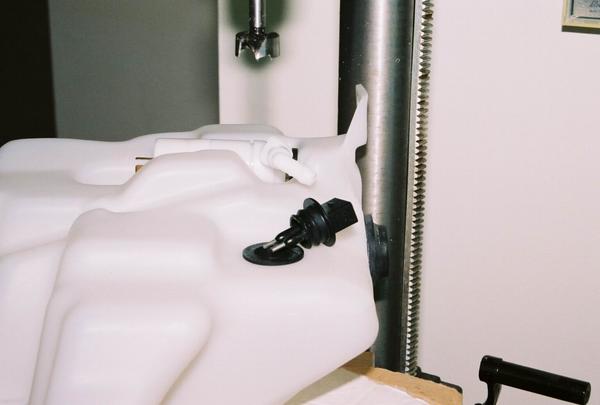

If your tank has the level sensor hole install the old level sensor using the old grommet.

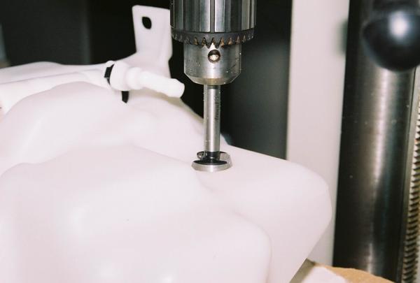

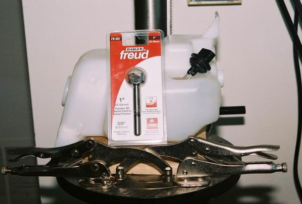

If your tank, (like mine), doesn't have the hole for the level sensor don't despair! A hole can be drilled in the tank without too much trouble using a 1" Forstner Bit.
NOTE: When you drill the hole, (best done on a drill press after measuring 27 times to make sure you have it in the exact same relative position as the original bottle), you may find that the sensor fits in very tightly or doesn't want to go in at all. DO NOT SAND THE HOLE TO MAKE IT BIGGER! The reason it is not going in correctly is because the hole has a ridge formed on the inside from the drilling. Take a knife and scrape the ridge off and the sensor should fit in nice and snug and not leak. (Or you can do what I did. Sand it with a drum in the drill press. Make it oversize and have to use epoxy to help the grommet seal after all the water leaked out after installing the darn thing!) /images/graemlins/rolleyes.gif

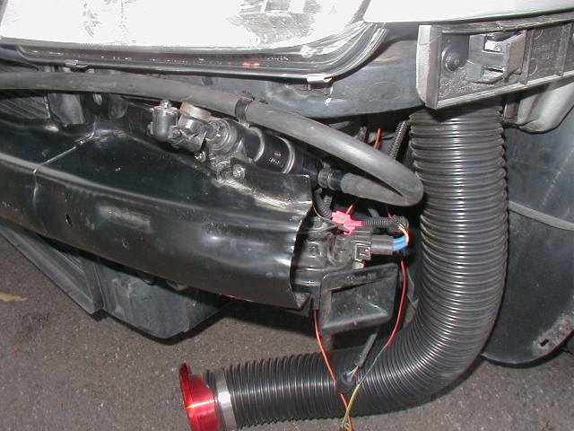

Once the bottle is installed you can proceed to the removal of your US rebar and replacement with the "correct" Euro rebar.
I think there are 2 bolts on the ends and various torx bolts/screws on the bottom and in the middle. (Didn't take a picture so I can't remember exactly.)
It has been brought to my attention that the support for the lock carrier is different to correctly support the euro rebar. The correct part number for the support for the lock carrier is 1J0 805 567.
(I didn't bother getting the new lock carrier support so didn't originally give the part number.)
For some strange reason IMPEX shows 1J0 805 567 as being equivalant to 1J0 805 567 B, (which is the US lock carrier support), with 2 different prices. I think it is the same situation as the euro rebar. VWOA is crossindexing the euro number to its american counterpart. Buyer beware!

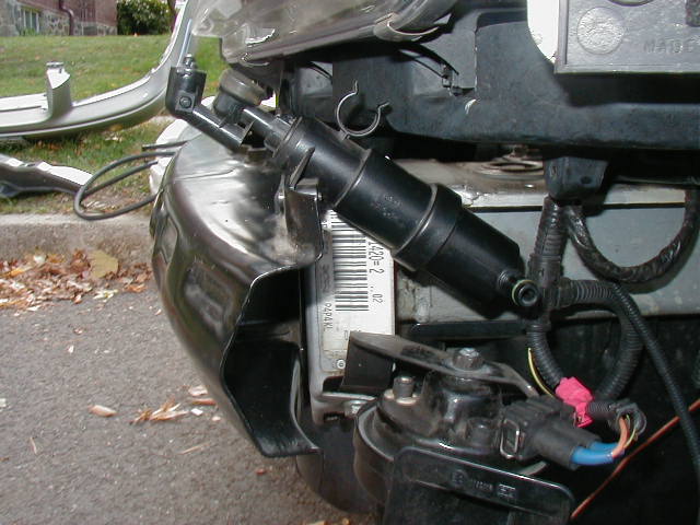

Once the Euro rebar is installed install the washer pumps.
They are left and right, (and are marked as such on the body of the pump), so don't mix them up!
BTW The bottom of the pumps rotate so don't freak out if the outlets aren't pointing where they should. /images/graemlins/eek.gif You can turn them to the correct orientation. /images/graemlins/grin.gif
With the nozzles installed it is all a matter of running the hose to each nozzle. It should look like this when done.

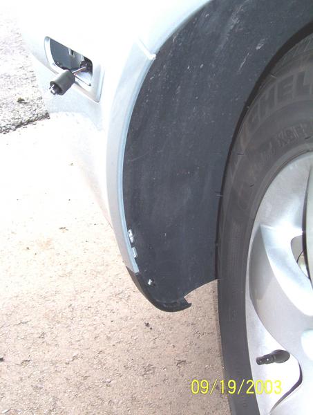

The rest of the installation is the cutting of the bumper but I don't have any pictures.
My bumper, (2003 wagon), had the dimples on the bottom edge so I connected the dots with a Sharpie and then I used a 1 3/8" Forsnter bit to drill out the initial hole and then used the Roger Moore drill method to open the oval up. I connected the drill holes with a cut off wheel in a Dremel and then I used a 1" sanding drum, by hand, to get the final shape.
Make sure you sand a little and measure the fit of the washer covers as you go until they just fit. They should fit without too much side to side clearance so they will always fall back to the same place after spraying your headlights.
Once the cutting is done the installation of the bumper and grill is the reverse of the removal! /images/graemlins/grin.gif
and
NOTE: The Euro rebar DOES NOT USE THE FOAM from the US rebar. It doesn't fit and the Euro cars don't use foam at all. Nyet, Nine, Nada, Nothing as SVTWEB would say.
