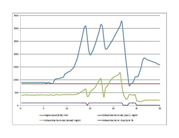

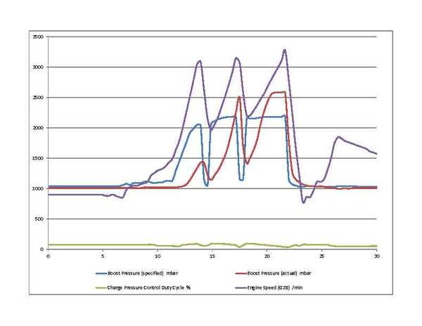

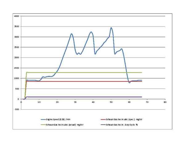

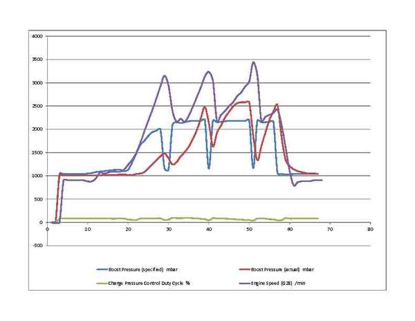

I first notice a buzzing sound, followed by the boost coming late. I've only experienced full limp mode one time.
I took some logs of blocks 011 and 003, both before and after disconnecting the MAF.
Before:
After:

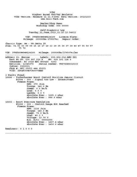

EDIT: Fault Codes
Any ideas? Questions?
