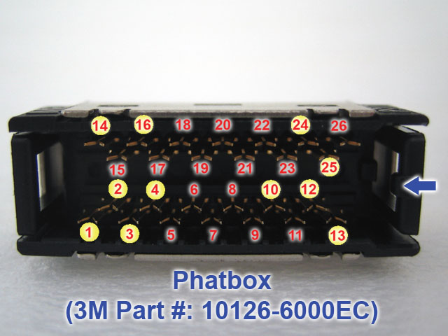

3M mini-D 26-pin Ribbon Connector: 10126-6000EC
[ 3M 10126-6000EC Product Data Sheet (PDF) ]
Purchase from: Mouser (US$5.20/ea, Mouser p/n: 517-10126-6000EC) or Newark InOne (CDN$7.47/ea, Newark InOne p/n: 52F7593)

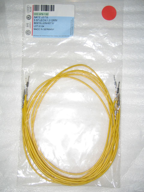

VW Repair Wires: 000-979-132
Quantity: 5 - cut in half for the 9 required terminals
Purchase from: Dealer (CDN$8.15 - *each*!! Find another source for repair wires!)

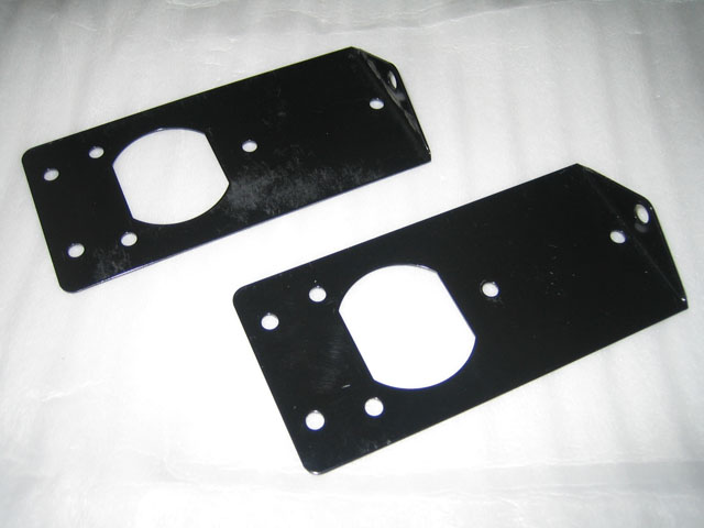

VW Phatbox Mounting Brackets: 1J0-035-234A
Quantity: 2 - left and right sides
Purchase from: Dealer (CDN$8.15/ea)

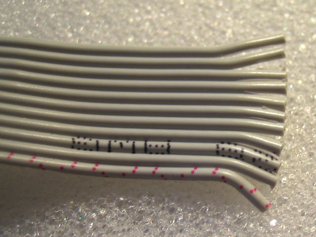

Ribbon Cable: n/a
Purchase from: Nearest geek...
I used IDE (hard drive) ribbon cable, which is readily available from any computer person with a closet. You only need 11 conductors, so just "tear off" what you need. Try to use the side of the cable that has the marked wire (note the red marks on the bottom conductor in the photo below), as it will be easier to keep things straight when you are wiring. A length of 6"-8" is more than sufficient.

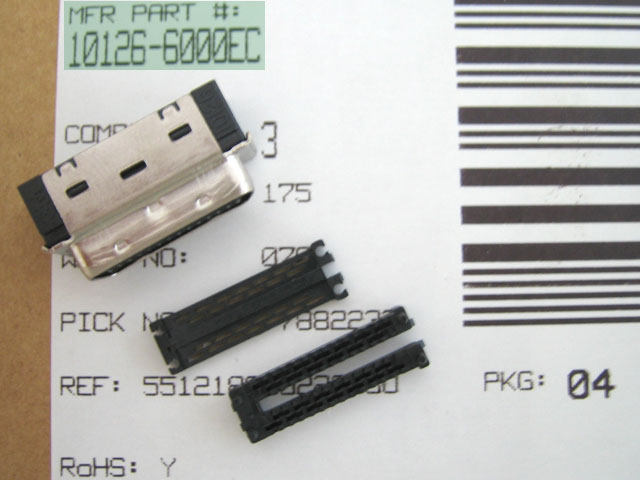

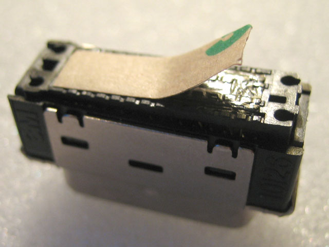

1. Take the 3M connector and insert the small piece with the adhesive backing into the connector. It only fits in one way; make sure you start to peel the backing before inserting it all the way into the connector.
2. Take the ribbon cable, which should have 11 conductors, and separate each cable from its neighbours by just 1/2" or so. As you manipulate the cable, you'll separate some of the wires more so that you can move them, but the objective is to keep it as tight as possible. I used a razor blade to "slice" the cable jacket between each conductor so that I could pull them apart (see photo above).
3. Do the same at the other end of the ribbon cable, although you can probably peel back at least 1". *Carefully* strip 1/2" of the jacket from each conductor. I simply used the edge of a sharp pair of scissors to strip the jacket off - a light pressure is all that's needed.
4. This is the hardest part... Press each conductor into the appropriate pin on the 3M connector. The idea is to have the cable coming into the centre of the connector, and then each conductor will either bend "up" or bend "down" to engage the appropriate location. In this way, you will then lock the connector with the third piece of the 3M package. There is only a very small amount of space to accomplish this, and you may need to separate the conductors further in order to manipulate and seat things properly. Use a small tool to push the conductor down to the bottom of the "V" of each pin. I used a flat head jewellers screwdriver. Be careful not to pierce the conductor jacket with the screwdriver. With the conductors properly seated, they are quite secure.
*** NOTE THE ORIENTATION OF THE 3M CONNECTOR!!! ***
There is a small detent on the side of the connector, indicated by the blue arrow in the picture below. Be sure to orient the connector properly before beginning so that you attach the conductors to the proper pins.

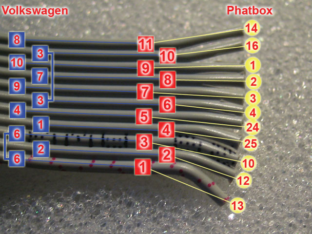

*** PAY ATTENTION TO THE NUMBERING!!! ***
Note that the ribbon cable is numbered with the marked conductor as #1. If you do not have a marked conductor, mark it yourself with something PERMANENT before beginning! The red numbers in yellow circles refer to the appropriate pin on the 3M connector for that particular conductor.
I found this sequence to work best for getting the conductors into the connector as neatly as possible. If you alter the sequence MAKE NOTE OF IT and be sure to carry it through to the other end!
Code:
Conductor  3M Connector
1 --------- 13
2 --------- 12
3 --------- 10
4 --------- 25
5 --------- 24
6 --------- 4
7 --------- 3
8 --------- 2
9 --------- 1
10 -------- 16
11 -------- 14
4. With all the conductors attached to the pins, use your multimeter/circuit tester to verify each connection. Put one probe on the stripped conductor end, and the other probe into the matching outer contact on the 3M connector. You will need a probe with a fine point to reach the precise contact in the 3M connector. If something doesn't work, fix it...
5. Once all connections have been verified, use the remaining piece of the 3M connector to lock the connections. It can only go on one way. Slide the connector onto the ribbon cable, and press down firmly onto the connector contact pins. It will lock in place quite securely. Whew. Hardest part is done.

6. Cut all 5 repair wires in half, and strip 3/8" to 1/2" off the cut end of 9 of the wires; place a 1" piece of heat shrink onto each wire.
7. Carefully twist the stripped end of each conductor onto the stripped end of a repair wire, and solder the connection. Finish with the heat shrink. Do just one conductor at a time, then twist the next, solder it, heat shrink it, and so on.
Remember that there are 11 conductors, but only 9 repair wires? Conductors 1 & 3 will splice onto *one* shared repair wire. Conductors 6 & 10 will also splice onto *one* shared repair wire.
You should now have a cable with the 3M connector on one end of a ribbon cable, and then 9 repair wires with the male terminals spliced onto the other end.
8. Insert each repair wire into the appropriate terminal on the VW connector. The terminal positions on the connector are numbered on the locking tabs, where the numbers are in the image below.
Remember that the ribbon cable is numbered with the marked conductor as #1. The red numbers in blue boxes refer to the appropriate terminal on the VW connector for that particular conductor. The sequence is:
Code:
Conductor  VW Connector
1 ----------6---
2 --------- 2   |
3 ----------6---
4 --------- 1
5 --------- 4
6 ----------3---
7 --------- 9   |
8 --------- 7   |
9 --------- 10  |
10 ---------3---
11 -------- 8
Before locking the connector, double check that you have inserted the appropriate conductor/repair wire into the correct terminal location. Once verified, you may lock the connector by simply closing the flaps until they "click" and lock.

2. You must drill a new hole in each of the brackets to adjust the depth that the Phatbox sits at in the cubby. On the centre line of the bracket, at 25/32" (just over 3/4") from the bottom edge, drill a 7/32" hole. You can test fit the brackets by putting the Phatbox in the cubby as far back as it will go, and then sliding the brackets in on either side and see how deep they go.
3. Bolt the brackets onto the Phatbox. I only used one bolt on each side, but I suppose you could use two, but you'd have to drill more holes. I used some mid-strength LocTite on the bracket bolts, and tightened them right up.
4. Attach your new cable to the VW cable found in the cubby space, and route the other end up and through the back of the cubby. This is a bit awkward, especially trying to make sure that when you push the Phatbox back, the cable won't bind up on anything. Attach the other end to the Phatbox.
5. Insert the Phatbox into the cubby and attach it. I found that the brackets weren't quite "square" to the mounting holes on the front of the cubby hole, but they were pretty close, and I was able to bolt in OK.

A much easier method of attaching ribbon cable to the Phatbox connector is to have two 13 conductor ribbons. Cut one end straight across. Do not strip the wires. Bend the cable at a right angle very near the end. Do the same for the other. Slip them into the slot of the outer retaining piece of the connector.
Notice that the wires of the ribbons fit in locations on one side of the retainer. The ends of the ribbons should be flush with the outsides of the retainer. The marked end is away from the slot opening.
Then you can peel off the paper and stick the other piece onto the wires. Align the large slot sides together.
Now press the retainer and ribbons into the connector. I used a vice on one side then the other. The teeth will slice through the insulation as each wire is pressed in.
Now you can separate the wires at the other ends and splice onto the repair wires, etc.
Granted you've got extra wires in the ribbons, but this is much easier. And you only have to know the relationship of Phatbox connector to VW connector. No ribbon 1 goes to Phatbox 13 and VW 6, etc.

Well, that made it sound like a much less daunting project. I was able to get things pretty much stuck together in a matter of 10 minutes or so. I just need to finish up all the connections & I'll let you know how it goes. I've always said, it sometimes takes a new set of eyes or ideas to make something like this seem do-able. Thanks for posting that up. :)

It's not really a new set of eyes (mine are wearing out) or ideas. This is the standard way of connecting ribbon cables to connectors. If we could locate a female connector for the ribbon cable, it would just be a straight pass through cable, as Lito suggested. The only ones in Mouser's catalog are for mounting on circuit boards.
I'll make another cable and add pictures to the post above. Mine works. I did use an ohm meter to verify the connections before plugging it all together.

I figured you all knew that... I did partially what MOGolf did, in that I didn't separate the wires that went to adjacent connectors (terminal #s 1-4, 12-13, and 24-25, FYI) It made those connections very easy to make, and didn't need to use a vise to crimp it.
Overall a great cable... Cheers!

Bump after adding the pictures.
