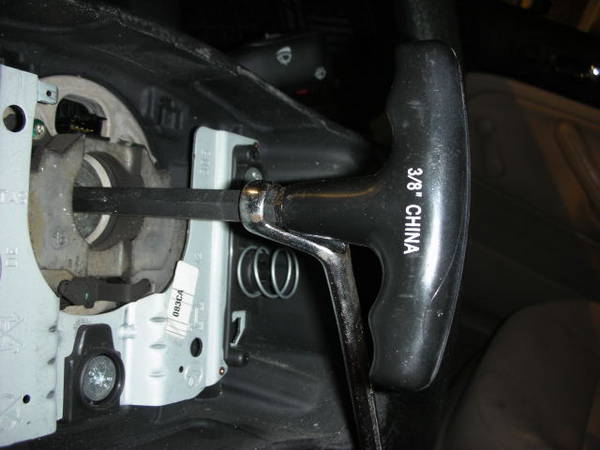

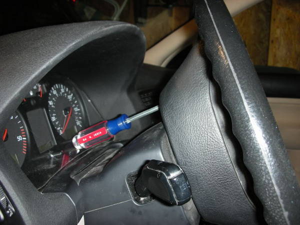

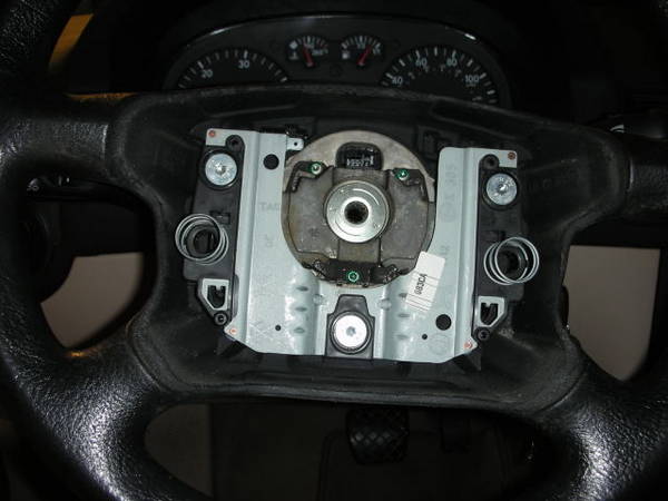

So since I had my camera I though I would post this:

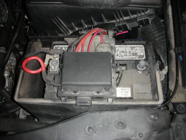

1. Disconnect Battery
2. Insert screwdriver in opening in back of wheel (See instructions above). This is the hardest part of the job. I didn't need to put the screwdriver in all the way. Lift the screwdriver handle up.

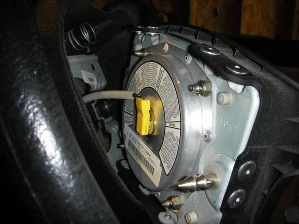

3. Remove airbag

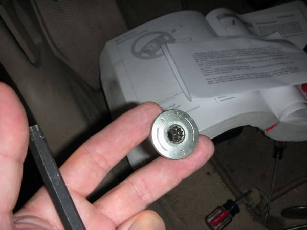

4. Remove center wheel bolt (I used a 3/8" Hex)
5. Make sure you mark the shaft and wheel so you know where to put it back on.

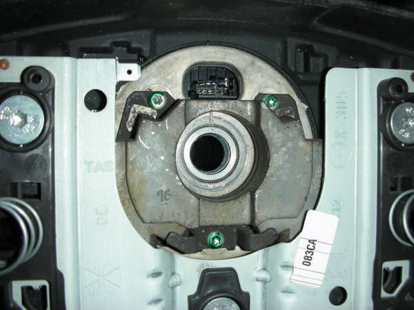

6. Remove wheel.

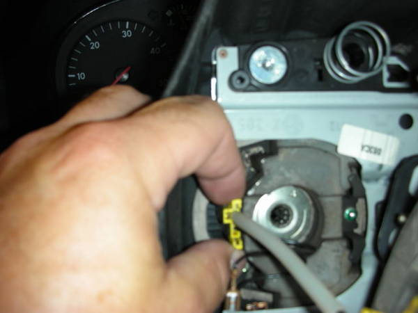

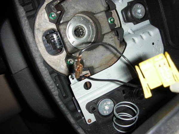

7. Remove screws to slide back plastic covers.
8. Unclip and remove the center circle thing? (three clips and wire connector plug)

In getting the airbag off - it helps to push it in a little whilst releasing the clip with the screw driver.

I had to pry the airbag off while pressing the lever. Unlike all accounts I've seen and read, it does NOT pop off! Required a significant amount of prying to get it off, perhaps because of the type of wheel I have - '04 TDI GLS with leather / multi function wheel.

At least I now know how to remove the airbag - just pry it off (while holding lever down) if it does not "pop" off like so many descriptions suggest.
