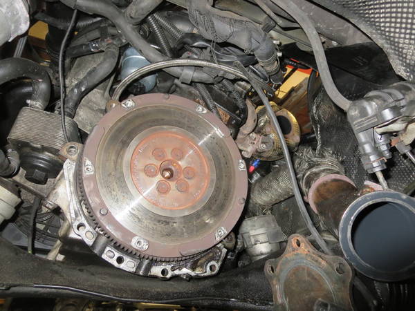

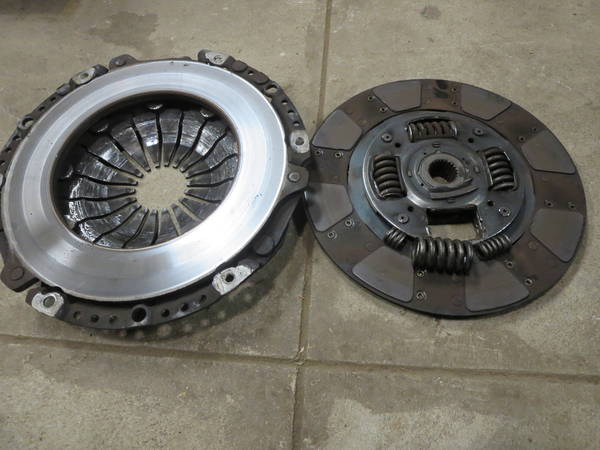

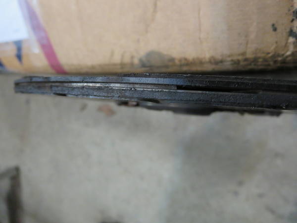

I have a 2006 Audi A4 that I bought with a BHW swapped into it. I have been working on finishing all the little details. This car is a 6 speed manual awd and I get 6.5L/100km on average so it make for a cheap and fun commuter car as I drive 1000km per week. The clutch has about 25,000km on it, its about a year old but today one of the clutch dampening springs wore out of the housing and got jammed between the clutch disc and the pressure plate fingers. I have been pulling trailers which weigh about 1000lbs total for about 5000 of those kilometers if that makes much difference. The flywheel is a Whitbread Performance 240mm SMF with a clutch masters FX250 clutch. I am wondering what to buy for a replacement clutch because I want to get close to half a million kilometers out of that car. I thought I should be able to get atleast 100,000km out of a clutch. I do mostly highway driving. I'm running a GTB2056 with stock injectors so I'm thinking the clutch will have to handle atleast 300ft/lbs.

I see youre running a single mass flywheel. I would say go back to a stock dmf and use a solid Sachs SRE clutch disc, should handle the torque of your gtb turbo...

ripping the hub out of a dampened disc is a very common failure mode, there's a good reason most heavy truck clutches are solid hub
with the sprung hub you have some windup before the springs reach the end of their travel, like an impact wrench, where the solid hub will just rely on your engine mounts to cushion any jerking in the driveline
if you can get a similar disc with a solid hub from a DMF application and use it on your SMF you'll notice very little difference in how it feels from the driver's seat, but you eliminate the failure point. Even gear rollover noise is the same in my experience, the only thing I noticed is that the engine flopping back and forth in the mushy stock engine mounts is a little more pronounced. I ended up filling mine with window weld to stiffen them up, you might be able to do something similar.

I don't know who is the real producer of the clutch plate from your kit but it should hold your torque.
You can try next time with a 3.0TDI/RS4 clutch plate 059141031P. It has 6 double springs and is built for 450Nm engine (3.0tdi BMK). On it's hub you can pur ceramic or whatever friction material you want.
