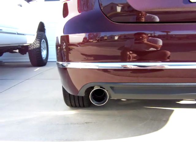

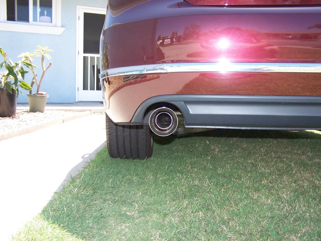

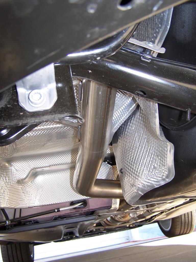

Here went mine. In the 3rd picture, you can see some minor scratches from the table on my sawzall as it bounced around a few times. It cut smooth and clean but took a few minutes to do so, given that the blade was somewhat worn. As for the 2 wiring harnesses above/next to the tubing... I turned the blade around/up-side down/teeth-side up (however you wanna interpret that) in the sawzall so that I was pulling it towards me in order to prevent catching the wires once the blade broke through the other side.
I'm going to run it as is for a little bit and then check all the connections again to make sure they stayed tight and to let everything settle into place. I'm hoping I can get the tip moved over to center it in the cut-out of the valance. Seems as though the hangers are gonna keep it where it is now though. Until then, it's probably gonna drive me crazy! :rolleyes: I also noticed that the front section is awfully close to the crossmember (in the 4th picture) as it turns horizontal above the subframe/suspension assembly. I could hear a little bit of a rattle during a drive to dinner while making some turns and very minor rattling over most bumps in the roads. For this, I think the hanger just in front of the rear-end can be persuaded some in order to lift the tubing a bit for better clearance.
And........
Lastly, upon arriving to dinner, the engine started a regen cycle. I sent everyone else inside while my dad and I waited for it to complete. My dad then called to me from the back of the car. As I approached, he pointed at the tailpipe. :confused:

Anyone still trying to center the tip in the reveal of the lower valance? ;)
Also, here are a couple more pictures from underneath.

I had to pull the two pipes apart at the slip joint clamp about 1/2" to put it in a slight bind to hold itself up off the rear axle just a touch more than it was. It now has about 3/8" of clearance up over the axle so when you hit a choppy spot in the road it doesn't go bump bump bump on the axle :D
