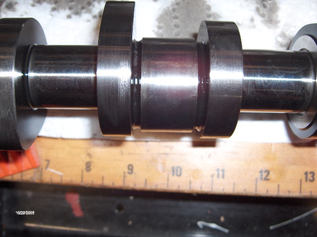

This might be a good time to show this issue I found with #1 and #2 exhaust on the base circle. The pickup is exactly opposite to the apex of injection lobe. I caught this at about the same time the black was wearing through on the follower. I have my own theory as to the cause but so far have not been able to solve my follower issue. I tried to solve the pickup by preventing the cam from moving around in the bearings due to the valve spring and injection forces causing what I believe is an up and down movement. But so far no luck.
Edit, Notice how roughly my cam was ground, the pickup highlights this.

Got a better pic? Thats a bit grainy for me.

Here is the same thing on exhaust #2.
Basically my thinking is if you have a cam ground rough, more than .4 Ra (Ra=average micrometers), the nose may breakin but the base circle will not and the injection pressure pushes the cam down and squashes the follower against the closed exhaust valve at top dead center of the compression stroke. This constant rubbing would generates a lot of heat. Now a cam with a very smooth grind would have a better change of not rubbing due to asperities not breaking through the oil film on the base circle. Note the scoring is exactly opposite to the top of the injector ramp.

Links appear to be broken.
