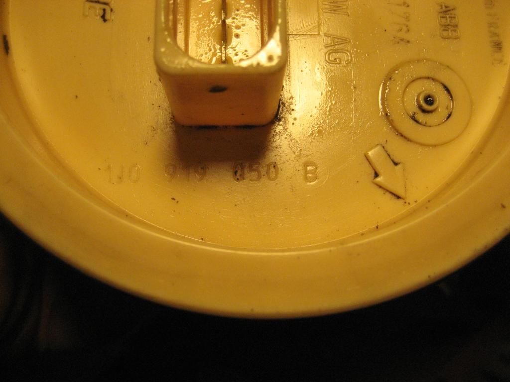

Anyone know the part number of my (2005 Golf TDI BEW) pump? Etka?
Need to try locating a replacement (used or cheap fake).
Part number may also determine what potential donor cars have suitable pump (junk yards, ebay).

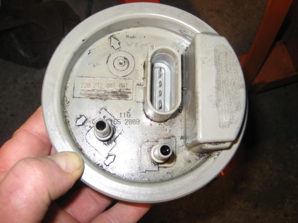

JY said diesel. Original pump was: 1J0 919 050 B
Here is the part number and photo of the JY one I have installed:
VDO
220-212-001-001
Pressure [bar]0.5bar Fuel Type Diesel
Only showing BEW engine code for Beetle:
NEW BEETLE
1.9 TDI [ from 2001, [ATD], 101BHP ]
Engine Code: ATD
Fuel Supply: for vehicles with fuel cooling 1.9 TDI [ from 2001, [BEW], 101BHP ]
GOLF MK IV
1.9 TDI [ 1998 to 2001, [AJM], 115BHP ]
from Chassis No.: 1J-1-300 001
Engine Code: AJM
Fuel Supply: for vehicles with fuel cooling 1.9 TDI [ 1998 to 2001, [AUY], 115BHP ]
Engine Code: AJM
Fuel Supply: for vehicles with fuel cooling 1.9 TDI [ 2000 to 2005, [ATD], 101BHP ]
Engine Code: ATD
Fuel Supply: for vehicles with fuel cooling 1.9 TDI [ 2000 to 2005, [AXR], 101BHP ]
Engine Code: ATD
Fuel Supply: for vehicles with fuel cooling 1.9 TDI [ 2000 to 2005, [ARL], 150BHP ]
Engine Code: ARL
Fuel Supply: for vehicles with fuel cooling 1.9 TDI [ 2000 to 2005, [ASZ], 130BHP ]
Engine Code: ASZ

Could the pump be the cause for the leak? Or should it work? Junk Yard guy naturally doesn't have a clue (assumed 2004 Jetta, but said it was a diesel; pulled this morning after I called, but I did NOT see the car).
Engine runs, just pissing diesel. Could be "T" O ring fit old filter, but not a good fit for new filter?
