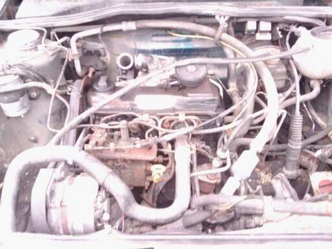

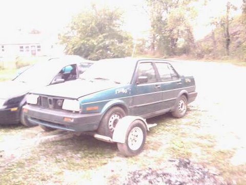

Well, I've done it again. I just picked up a 1992 ECOdiesel in Capri Green. Really odd car... no sunroof and no cruise control . Only 150,000 miles! It's not running, and I haven't had time to mess with it a ton yet. It's all there though, right down to the little bolt on the timing belt cover. (I had removed some things when I took the engine picture) More updates to come!

I saw the car this weekend. It's pretty clean! Not a bad find for a few hundred bucks. Hopefully it will be up and running again soon. :D
