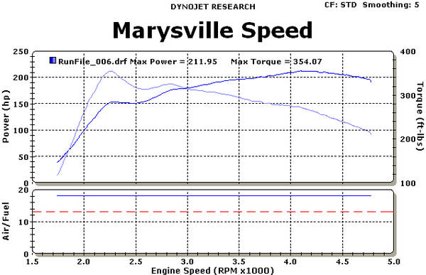

Dyno'd the 2dr today for the first time with the PD. I brought along two ECU's and a tuner (thanks Mike!) to test. First up, I ran the RC ECU as it felt the most powerful between the two. The dyno operator told me 140/319 and I about lost it until I realized the optical pickup dropped at 2300 rpm LOL. Second run on the RC5 ECU and he said 214/323! I knew the HP was there but was surprised to see it up so high, and I was a little dissapointed in the torque. This ECU felt like the torquiest TDI I've ever been in.
So, next up was my tune I've been driving daily from TDTuning.com. 207/347 :) Not bad but Mike wanted to adjust the timing a bit to find the sweet spot. A few pulls later we settled on 211.95/354.07. Yes, it's smoky at WOT but it's not too shabby for a stock sized turbine :eek: Here's a graph and video
The little dip there in the beginning is more than likely either the boost isn't ramping up to 26 psi right away or it ramps, dips and then goes about it's business. Not too worried about it as I don't make it a practice to WOT at 1600 rpm in 4th :rolleyes: On the street, I usually don't WOT until about 2500. The dyno operator used STD correction whatever that means. He told me that he set the software to recognize that it was at 100ft altitude which is about right for the area there. I saw him switch it from STD, to SAE, and the difference was only about 1-2 hp. It was also 89degF in the little dyno room :eek:

To finalize things up, the car runs EGT's of 1650 so it's pretty hot but manageable. It runs 26 psi most times but may occasionally hit 27. Most importantly, I'm DONE messing with power enhancements (until I blow up the turbo and then it's compound time!). My goal when I started on this car 2 years ago was 200/350 and I'm finally there :D:D:D

TDIRacing- No, I don't have the RC graph. It had a similar dip in the torque peak (but 20 ft*lbs less), and 2 more hp from about 3800-4300 where the power bump is. Power buildup prior to the spike was a little slower as well.

MHA- I should point out that all runs were with the Devils Own W/M on. 95% water. EGT's maxed probably because of the inefficient turbine at those power levels.

How much do you think the W/M injection contributed to your result? Given how easy it is do and the disagreement of the gains, wouldn't it have been instructive to run some of the runs both with- and without back-to-back?

I must admit I was a bit taken back by the small tire-fire. Time for more air (GTB2260VK ??) methinks. Fueling that hard, I imagine EGT's are teetering on the edge of manageable. Regardless, you won't find me challenging you soon...:D

From my own non scientific testing, w/m lowers my EGT's about 150 degF. I wouldn't even do a full 4th gear pull with that much fuel without water. So if you look at it that way, you could guess the water was worth 10hp maybe? I don't know...
On my last dyno (where I cracked a piston) I did runs back to back with and without 50/50 w/m and it was a 6hp difference... So now I rely on the timing of my injectors for fueling, and just use water to cool it a little bit.
