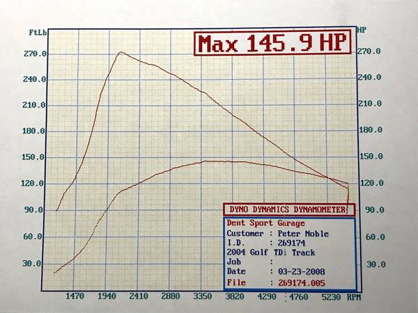

Here's an example of a TDI dyno with a high rev tune (RC3 for 6000 RPM) This is in my '99.5 Golf, ALH engine. Dyno operator got the wrong model year.
You can see where the HP and torque numbers cross at 5250 RPM.
This car had stock internals, PD150 breathing mods (airbox, snorkel, airbox to intake, MAF, Intake manifold), PP520 nozzles, and a lift pump. Stock turbo. This is a conservative dyno.
The benefit of the higher RPM tune is that you can hold gears longer. This was a track day car and it was very helpful for me to be able to run to 80 in 3rd and 115 in 4th. But the engine isn't in its most beneficial RPM range above, say, 5000. It also makes a lot of heat at those revs. I've seen coolant temps in excess of 240.
