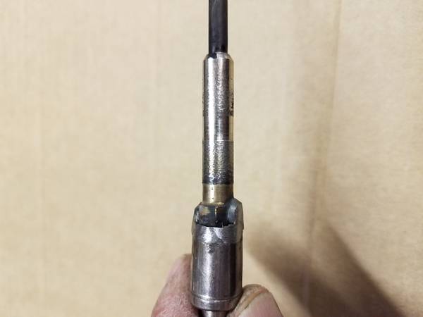

i like the drill bit idea, below is what i use

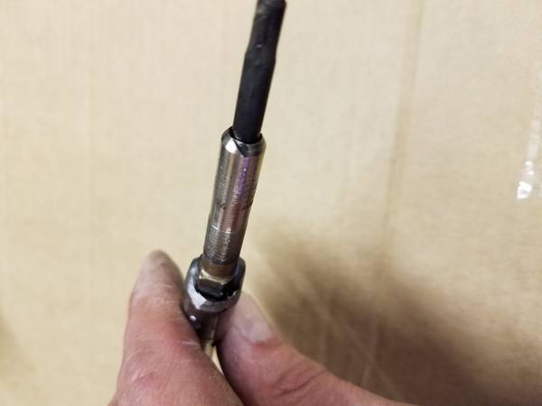

modified beru plug with three small "flutes" cut with a dremel... chucked it up and spun it in my drill press while filing the threads so it can free spin in the plug bore
showing the now threadless shank

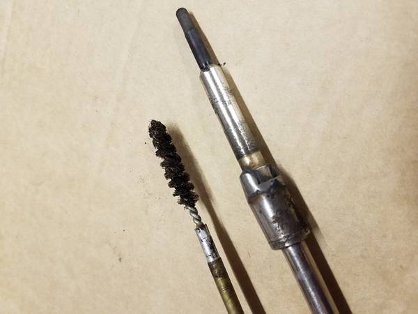

the two glow plug bore cleaning tools i employ... not shown is a 10x1 tap embedded in a 1/4 drive socket
About the brush: size, material, and where to get it?
2004 Jetta BEW 5M - 470k - 47 mpg / Fuel B-20 / Fuel Filter - Cat IR-0750 /
Oil Filter - Hengst / Oil - Schaeffer Supreme 9000 5W-40 /
Bypass Filter EaBP100 /
Air Filter - EaA208
/ Transmission Oil - VW G50
phaser is offline   Reply With Quote
Old January 14th, 2018, 11:50   #10
JETaah
Join Date: Jan 2001
Location: mi 48xxx
Fuel Economy: 53 max, 42 min, average 46
Walmart
44 caliber gun brush
EDIT:
38 caliber will be closer to glow plug diameter.

Originally Posted by JETaah View Post
Walmart
Is that a metal or nylon brush?
mine is brass
