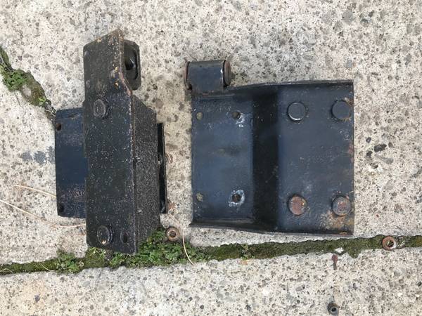

Just as the TDI engine and transmission were being test fitted for the very first time into the Comanche, we hit a bump in the road in the form of the old AX-5 transmission mounting bracket from the 86 truck does not fit the new, stronger AX-15 transmission. So I asked Whitbread to move on to someone else's work while I search for the right part. That was April 22.
AX-5 bracket below.
AX-15 bottom side where bracket mounts
Here is the correct bracket I needed. It is on the right in this picture.
Searching the Jeep parts catalog in the transmission section comes up with nothing even close. Google search come up with something called "AX15 Torque Arm Bracket" with a part number that is no longer available.
A request for help on the Comanche club get the correct page and diagram for the part we need. The diagram is in the "engine" section of the parts book. NOT the transmission section - no wonder I couldn't find it. After a search with the right part number - we find it is a discontinued part. So back to Google and to Ebay looking for the part. Found one on Ebay for about $200. So I keep searching with not much more luck.
Post another request for help on the Comanche club and in less than a day - the needed part is offered for $20 plus postage. Aren't these online forum guys great at helping out? The part was mailed Monday morning and arrived Wednesday afternoon. Bingo - we are back in business. Except Matt is working on another customers car now. (Remember, I asked him to move on from my car).

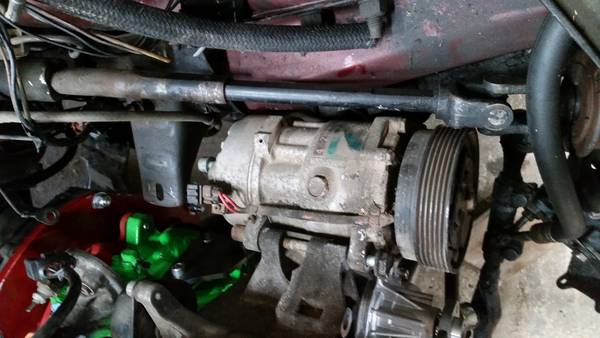

Next problem. Whitbread asks if I really want air conditioning on the truck?
Yes! I certainly do. Why do you ask?? Notice the steering column and the A/C compressor?
So I asked about mounting the a/c on the other side of the engine? Unfortunately that would be right in the way of the turbocharger. So that is not the solution. More on this later... when the problem gets solved.. I hope any way.

AFN B5 A4 has the AC compressor on the passenger side of the engine below the turbo - should be fine no? Can take pictures if desired. BHW bracket should be similar.
If there is little to no angular rotation at the steering U-joint you can replace it with a rag joint maybe. It's a little more compact and should sit closer to the steering box to clear the A/C clutch.

Matt was going to look at reversing the transmission cross member to move the engine over a couple of inches. He was worried about screwing up the turbocharger path by moving the a/c to the other side of the engine. So, Dave if you wouldn't mind sharing the picture of the AFN a/c mount that would be great.
Rockwell, never saw a rag joint before. Very interesting solution. Thanks for that pointer. Where do I get one??

Hey John - I have a BHW AC bracket and belt tensioner that I didn't end up using - let me know if you have a need for it.
I am not sure if would fit the AHU/1Z. Whitbread would also have to make up something like Jimbote did to mount an extra pulley on the harmonic balancer.
Look at post #93 here: http://forums.tdiclub.com/showthread...=293577&page=7 for more details.
That is a good post. If the simple stuff doesn't work, I will be looking for that mounting bracket. But as of now, he is going to move the engine over first and see if that works.

You can find 20 brackets for that on eBay.
The bhw will not work..thats the newer block.
It's from an early 1.8t in the Audi A4 as well as the Passat. They used the old style block.
It is a bolt on and go.
