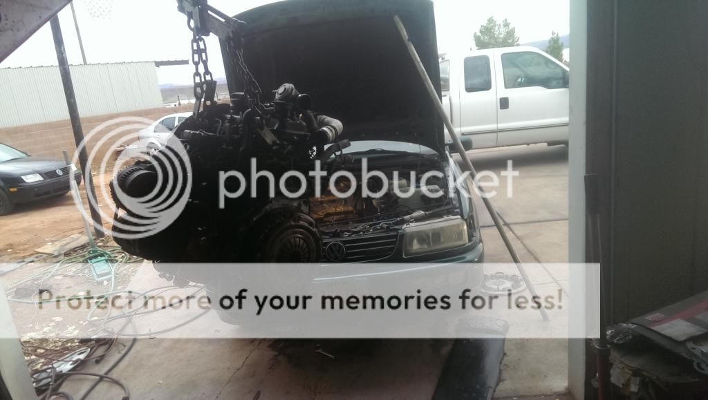

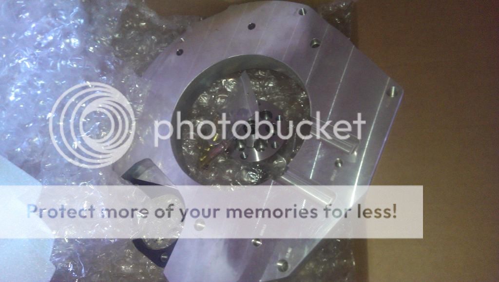

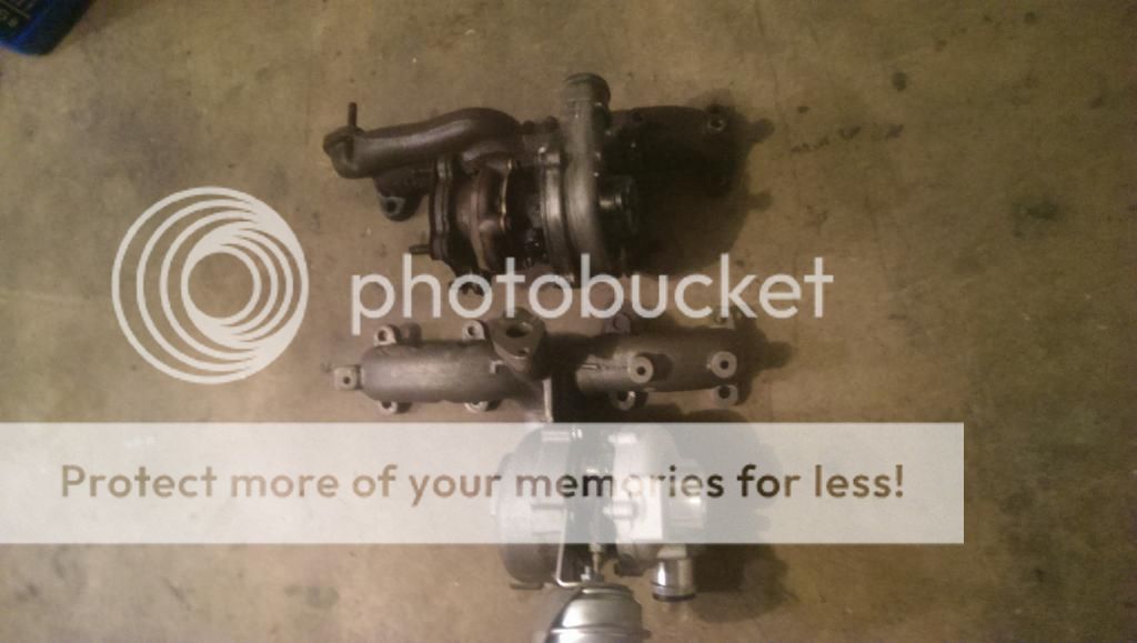

so im in the process of converting my dakota to a tdi. first removed the tdi and wiring from the car the old turbo next to the new turbo the adapter form coty build the truck its going in heres the first test run to make sure all the wiring was set up right https://www.youtube.com/watch?v=pIJ9xkGtvLA then after the new turbo,timing belt, cleaned out the nasty intake, and misc stuff https://www.youtube.com/watch?v=wNfnd0_8wfk now its ready for the dakota, soon the dakota will get torn down

so my nv3550 showed up. had to notch the adapter for the vacuum pump
its all together sitting in just need to make my mounts and hook stuff up
