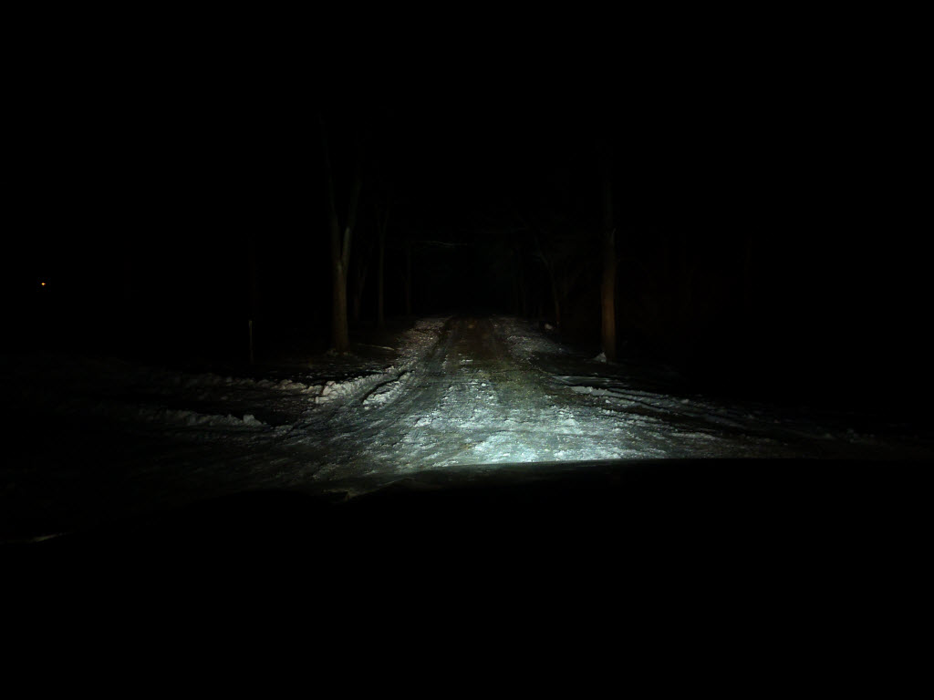

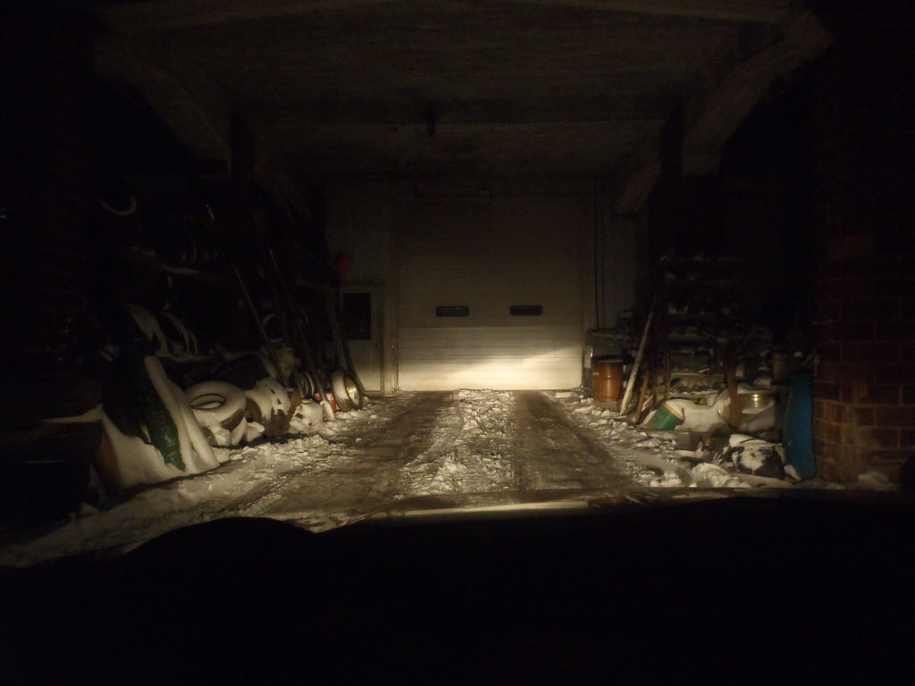

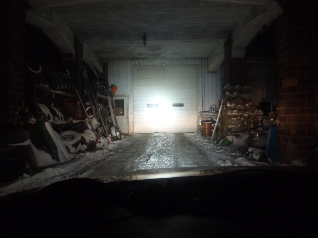

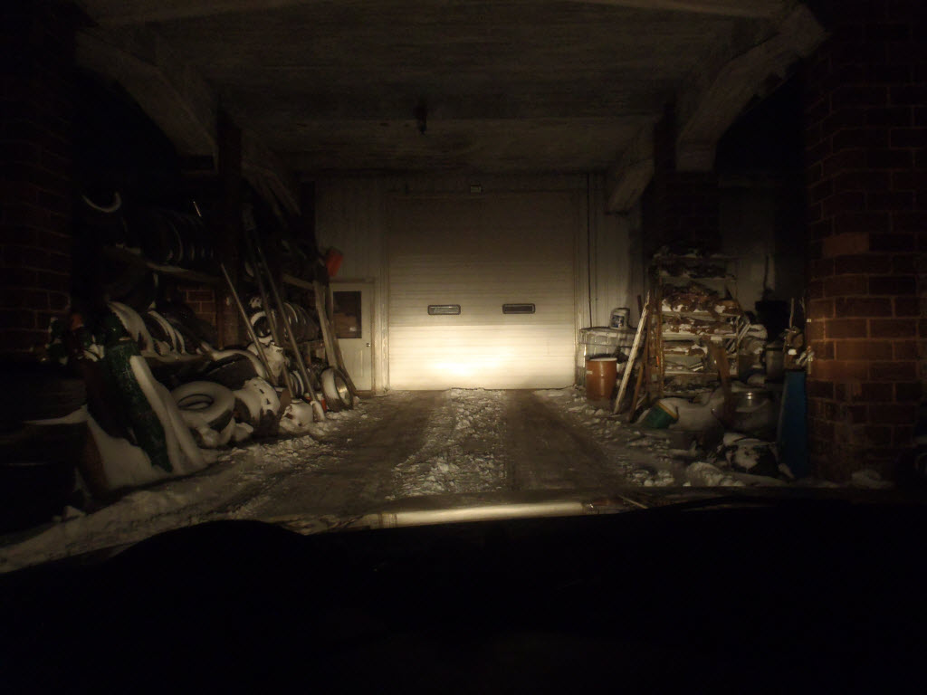

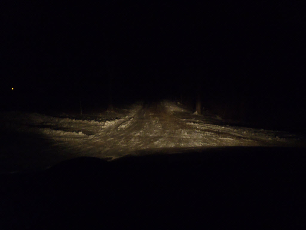

I'm not a photography expert, but I tried to take some pictures of the lighting. I just set my camera on the steering wheel, let it auto focus and select the exposure and push the button. I think the pictures are representative.
E-Code Low Beams only - the door is ~35 feet from the front of the car
E-Code High Beams only
Rigid 20" E-Series with the E-Code High Beams

It's aimed a bit low so I tilted it up after these pictures which helped light things up farther away instead of right in front of the car. In some ways it's not as bright as I had hoped, but when you turn it off you wonder how it got so dark.
Overall I like it, I think it looks OK and performs well.
