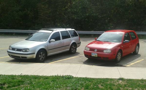

ya ya, i know pics.. here you go. from the trip home.
and some of the cosmetics to fix.

some pics of the fun so far.
Here is what an airhammer can do to the rear axle bushings.. this was lots of fun.
Also got a good visual on what the banging the suspension was doing to the rear bushings.
here is what the metal looks like normally, (surrounded by rubber of course)
And here is what many MANY miles of banging and clanging over every bump looks like..
Sure glad I replaced those..
Here is the engine compartment with its shiny new red silicone vacuum lines. mcmaster-carr FTW.
and the headlights with the shiny new hellas installed. much gooder!
~Aaron~
