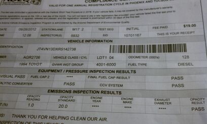

Well, today is a very special day. Took me about 3.5 hrs to get all of the Emissions/Referee/MVD work done, but I now have one Emissions legal Toyota/ALH on the road. Driving it today was petty cool, and I really need some taller tires. Even with the V6 trans, 3K at 70 is a little high for my liking.
Toyota Diesel, with 1.0% Opacity, sweet!! This is just the Stg3 TDTuning tune only.

Well done. Kudos.
Can you swap ring and pinions to lower numeric ratio? Sucks having to do two axles, though.
