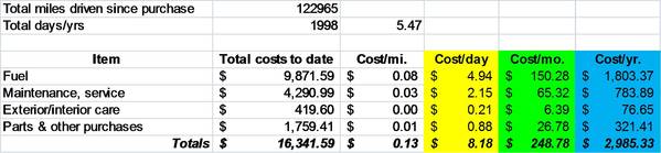

This is a snapshot of the operational expenses I've had so far on my 2004 Jetta. Maintenance includes all scheduled items (including TB). My cost/mi. has been consistent for nearly 3 years. I wonder how this compares to other auto manufacturers.
WOW. I'm pretty sure that you are in econo car/toyota Yaris type car territory with that number.

Does that includeall of your UNscheduled maintenance? many people (and many salesman) brandish "low maintenance costs" by estimating "scheduled" maintenance only, but fail to account for UN scheduled services.
My UNscheduled repairs have been FARRRRRR more costly than any of my scheduled maintenance, including my TB.
Originally Posted by pastormike View Post
OMG!!!!! you've spent SIX THOUSAND DOLLARS on maintenance alone (16341.59 less fuel costs of 9871.59). That is just under a thousand dollars per year in repairs!
The costs include UNscheduled repairs and parts, too.
