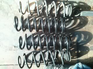

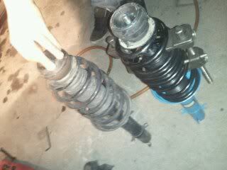

out side springs are the old ones, terrible picture but all i could find right now.

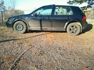

Side pic of the car from cell
this is a side view the day after i finished in a drivelane. trying to use what little winter sun i had.

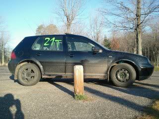

Pic at a local park, same trying to get the sun to show
new vs old on the way in at 11 at night, to tired to have taken a good picture apparently, regreting now...
another late night picture of the difference, still sorry for the low qual

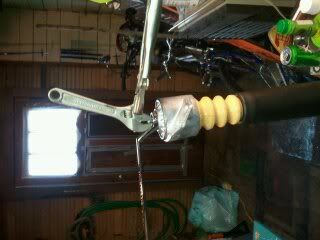

Making it work and yah gotta get it tight! ignore the backround, College kids shop...
Now the Actual Measurements...Sorry i just got to Excited to take before pics...

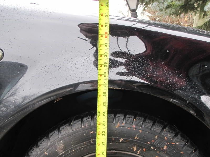

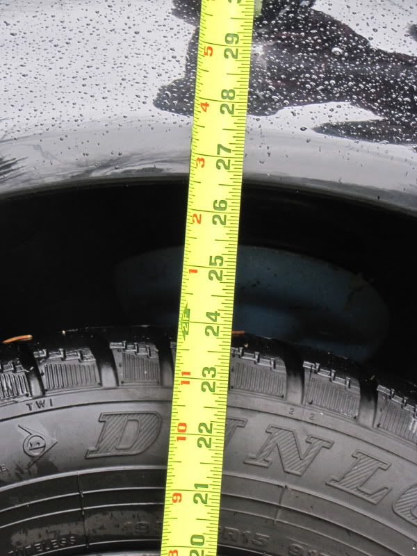

front pass
front driver
Driver rear
Drivers Rear zoomed out
Pass rear
front Pass
Front Pass Zoomed out
front pass
as others would say Yah its dirty, i wasnt gunna wash the Golf to show my "Lifted" refreshed suspension. figured it worked with it haha. Hope this helps any one thats riding the fence. DO IT ITS GREAT! Cant beat the price. Under $500 with Shine RSB and only reused two bolts and two parts off the front suspension to hold the spring on the strut. All done in my single car driveway.
Have Questions? Please Ask, more than happy to explain anything i can! Pm me too.

Thanks for the pics. That helps.
With my current set up I am 28" front, 29.5" in back. I am going to order springs for the front only and disconnect the front swaybar.
