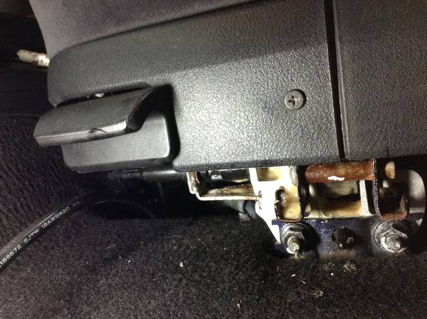

A couple of pictures for clarity.

Pull off the front trim piece and start cleaning and lubing stuff. Happened to mine last fall, pin wouldnt go back in by itself. Grease was dried on and caked, first cleaned it off and reapplied new stuff. Smooth as silk now.

The pictures in this thread totally saved my bacon! Scary incident of seat flying back while driving - just couldn't get the seat to lock - visited this thread, used some WD40, and it seems to be fine now. Thanks!

I sprayed some Wally World Carb Cleaner on the thingy in the pic above .... loosened up the device and it works fine.......... that was about 15 months ago! Still works great!
Took less than 15 seconds to free it up!........... didn't have to remove anything! Found some pocket change under there!

This happened to my passenger seat last winter. Remember to unplug the battery or else your ABS light will be stuck on. Pull the seat out and clean up the lock cylinder. It gets gummed up and the locking pin stays in the open position. While you're at it, clean the seat glide rail.
This happened to me just today on the driver side, I don't have time to properly fix it. I was successful at heating the lock cylinder with the seat all the way back with a heat gun. It heated up the gummy crap enough for the lock to work again, albeit temporarily, but if you're in a bind try that method.

I found it easiest to use a spray lubricant with a straw attachment.
Position the seat all the way back.
Spray from the outside side of the seat towards the centre of the car, through the hole in the bottom rail, which the seat slides on, in particular the hole near the seat front where the locking pin is.
