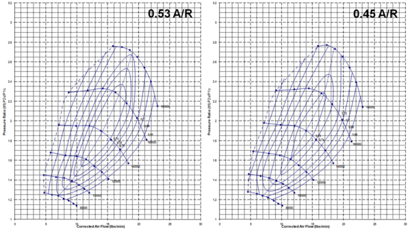

Varying the compressor A/R ratio has little effect on the compressor map, as can be seen in the two maps placed side-by-side below. The same generation, family, exducer diameter (52mm) and trim (55) are compared with two different A/R ratios - 0.53 and 0.45. They both look almost identical.
So what actually changes by varying compressor A/R? Looks like the one with lower A/R actually would be able to produce a higher PR still very efficient if it had'nt been for the RPM limitation.

The two particular maps showing different A/R ratios are too similar to draw any hard conclusions between them. However, when a choice is available, smaller A/R compressors -- other parameters being equal -- tend to be deliver slightly higher pressure ratios for a given shaft speed and mass flow. But again, the differences shown above are practically negligible.
