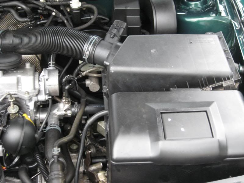

today the skis cleared up just enough for me to pull my little green TDI up to the garage to swap my crap cone filter with my stock air box
i first compared the size of these filters
by bending the paper filter around into a cylindrical shape
beside the cone filter it looks like this
as you can see the paper filter is significantly larger in all dimensions
it also has more pleads
this means the total surface area of the paper filter is significantly larger.
without actually measuring and doing all the math my guess is that its between 2 and 3 times the surface area of the cotton filter
i set up my wet/dry vac to test the flow differences
i was not able to reach the flow limit of either filter however
(yes i did this project on the ceiling)
with the vac ON
it pulls zero vacuum with nothing connected
and with my hand covering the inlet the vacuum pulls approx ~3in.Hg of Vacuum
next i hooked up each filter to the vac and tested each
each pulled 0 (zero) vacuum
both times the needle seems pegged right in the exact location the needle sits with no vacuum applied as well as the same amount pulled by the shopvac with no restrictions
finally i installed the stock air box
my conclusion
connected to a 5hp wet/dry vac neither the stock air box nor a cone air filter produce a measurable amount of restriction measured by my inexpensive equipment

Am I looking at something totally wrong or did you reinstall that airbox with the big gaping gash on the underside?
Old August 30th, 2010, 15:47   #26
Ben Dur
Ben Dur's Avatar
Join Date: Mar 2010
Location: Pensacola FL
it was my take on the "swiss cheese" mod
doesnt really negatively effect anything
its a larger area than the stock inlet
and given the car has none of the fresh air piping or dams that were provided by VW, it really doesnt matter...
