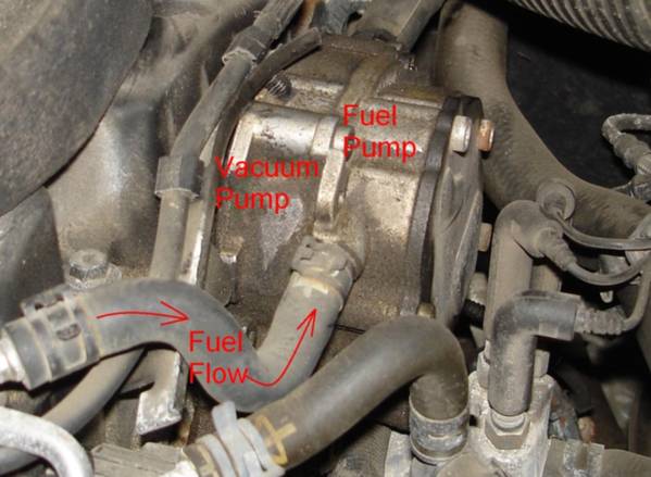

Let me explain why this works. The tandem pump is driven by the camshaft and has seals in it to separate two independent pumps stacked together and using a common shaft. The left side of the pump develops vacuum for your power brakes and all the vacuum servos such as the EGR valve and Turbo controls. On the right side of the tandem pump (as seen in the photo below, not actual as in the car) is the fuel pump section. So when you let your car sit overnight the little seal between the vacuum chamber and the fuel chamber lets tiny amounts of air in. The weight of the fuel in the fuel line wants to fall back into the tank, and as the air slowly, ever so slowly, creeps in the fuel flows backwards – back towards the tank. If the tank is full and the rear end of the car happens to be much higher than the front of the car this problem doesn’t show. If however, the tank is only full, and the front end is higher than the rear, the problem is magnified. In this case the engine would certainly stall after initial start-up. Why does it start at all? There is still some fuel in each injector pump jet and the fuel supply line between the mechanical pump and the individual injector pump jets. The engine starts, uses up that little bit of fuel, and when no more new fuel follows due to the air lock, which had all night to develop, it stalls.
In this picture just imagine the shaft seal lets in air from the vacuum side to the fuel side.
Having the check valve in this line prevents the fuel’s weight to “pull” air past the seal causing the airlock. I would have preferred to have the check valve right there in that short bent hose to get it closer to the problem area, but space looked like an issue, and secondly, with the valve next to the filter, it will make filter changes easier in the future. The next photo is the valve and its’ package so you can recognize it easily.
(9/16" clamps not supplied)
