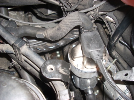

Here's mine, Zerostart Series 8000 750 W. I used 1-elbow NAPA ECR hose PN 11025 and 2-worm gear type hose clamps.
The hose is installed on the supply side of the OHE. This way the oil in the OHE gets warm up first.
The NAPA store where I got the the hose, had very limited heater hoses. So, I got what looked to be the best fit, since I had very limited time to install the coolant heater. I'm planning redesign and use other better design hose in the near future.

TDI POWER, where on the car did you mount your heater?

HeavyG,
I'm sorry for the late reply. My wife just came home and I have to do pics compression in her laptop using MSO'07-the only tool I have. I hope those pics will help you.
