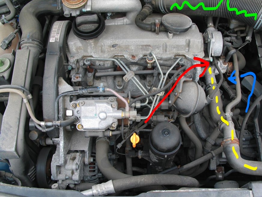

For those who will attempt this and, like me, have a hard time locating the sensor, here it is on my 2003 Jetta Wagon TDI.
Just follow the (yellow) hose a bit further towards the rear of the car, where the red arrow points (deeper down). You can get your hand in there, follow the blue arrow. You can also access it from the back by removing first the air intake (green).
The sensor''s wiring is pulled towards the back, then the sensor comes off towards the back as well.
