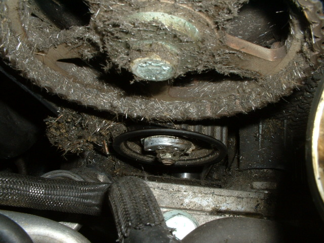

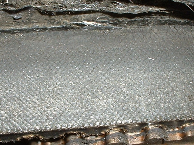

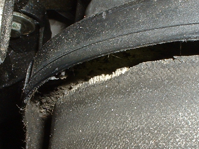

I could not check the timing on UG's car because the greasecar system covers the timing mark window.
The timing belt is shredding along the outside edges and the teeth are deformed on the inside edge. But there is no evidence of missing teeth or skipped teeth.
The car has been running - I checked the timing after it was warmed up last night and it was severely retarded. It would start ok once it was warmed up on dino fuel.
The belt is bad enough in appearance to give me concern about continued operation. I'll try to get some photos posted.
I am not sure you can see this very well, but the teeth along the back of the belt are crushed and damaged. Very strange.
DanG144 is offline   Reply With Quote

The belt is looking pretty bad.

Ouch! TB RIGHT NOW! Look for whatever is slicing and dicing the belt.

My best guess right now is that fuel is leaking out the injector pump shaft seal, softening and dissolving the belt.
I will keep looking for mechanical interference, but have found none yet.
Pretty spectacular.

The TB tensioner on UG's car is still right in the middle of the target window.

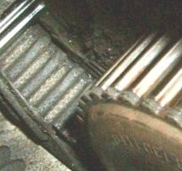

The timing belt seems to have jumped a tooth. The photo below is the timing mark shown with the pin in the injector pump and the cam plate installed.
No wonder VCDS showed "timing severely retarded".
It seems to have skipped only one tooth, and the cam and IP are still in time with each other - just out of time with the crank by one tooth. The car still runs, though it takes about 10 seconds of cranking to fire.

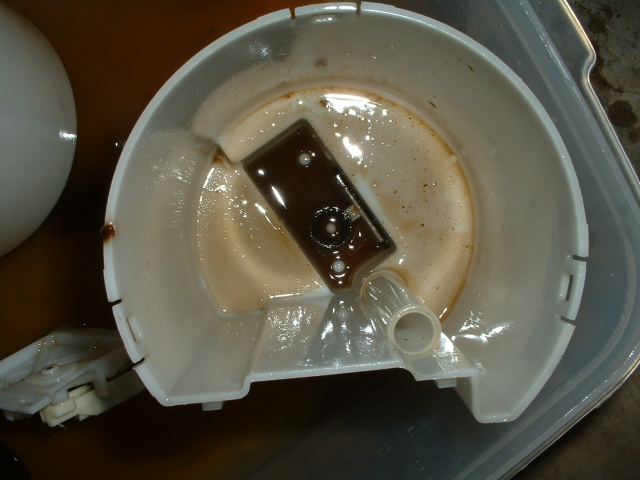

Pictures of UG's fuel pickup assembly. It was originally built as a "C" model, then altered to be an "H" model. This was apparently done by some vendor, as it now has a paste on label that says it is an "H" model. UG says it has only been in service "a very short time."
[IMG][/IMG] This is the inner fuel pickup canister. Note the sediment, some of which looks as if it is granular. Since this fuel had to go through the VO fuel filter, I am postulating that this is a precipitate of some sort. Or else the filter is blown through?

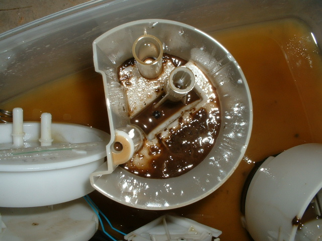

The fuel system seems to have had a control failure such that recirc flow always went to the dino fuel tank, even when it should have been going to the VO fuel tank.
[IMG][/IMG] This is a photo of the outer fuel pickup canister. It is much cleaner. None of this stuff was in the main fuel tank (no sediment or crystals), it all settled in the fuel canister, which is where the return fuel is dumped.
