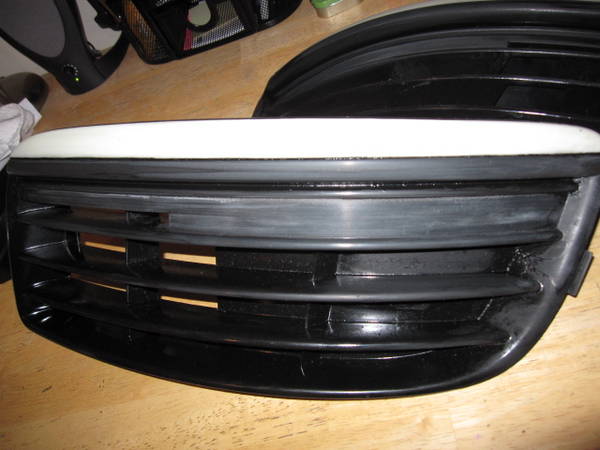

Basically, I used the file to wear down an edge on each piece of grill, then I used a razor to loosen that edge of chrome. After I had a loose edge, the chrome could be pulled off. You will just need to experiment as to exactly how this will work best for you.
Here is a picture of the slats after they have been pulled off from the grill--you need to be careful to not break the tabs when removing them. I found the needlenose pliers very helpful with that. They must be removed so that you can peel off the chrome and paint them seperately.

Ok, here is the partial after picture--the bottom side grills are giving me some trouble, and I am not finished with them yet. I have something else planned for the VW logo, so the black logo is just temporary.
I have been using black Krylon Fusion paint to do at least 2 base coats on the plastic, then Rustoleum gloss black paint on top. The Rustoleum has a much higher gloss, while the Krylon gloss looks more like satin. For those who are not familiar with Krylon Fusion, it literally fuses with whatever plastic on which it is sprayed. Oh, and it actually does completely dry to the touch in 15 minutes, so you get very quick results. So, it provides a very tough base coat which sticks very well to the plastic grill. The Rustoleum sticks fine after a couple of Fusion coats have been laid down.
You have already seen the main grill, here are the bottom side grills.
You can see that they are not finished. I have been having some orange peel problems with them, so I ended up partially stripping the paint back off of them, leaving them the way you see them now. I will spend some more time sanding all of the old paint off, then clean them more thoroughly before I repaint them.

So, you see the side grilles. I am still not satisfied with any of the paint yet. The main grill still has blemishes, and needs to be lightly sanded and painted with a couple of coats of gloss black. I would also like to put ~2 coats of clear over that.
As for the side grilles, take a look at the close-up pic:
You can see I have had some orange peel problems. I think there was something wrong with the spray can I was using, because I would sand through the orange peel, thoroughly clean the surface, then repaint with the same results. I will be chemically stripping the side grills completely after finals are over, so that I can resand and repaint on fresh, non-contaminated surfaces.
