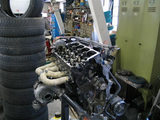

Some of you have followed my project and know pretty well what parts I have... My changes to this year is a new exhaust manifold, and stock intake manifold again. Looks like this:
With the same tune as last year, I got exactly the effect I was hoping to get, much better response and not so laggy turbo/spoolup meaning less smoke when changing gear etc. 28mmID pipes and almost as short as possible, not the best collector, but not that bad eather if you ask me  Have no better pictures I'm afraid..
