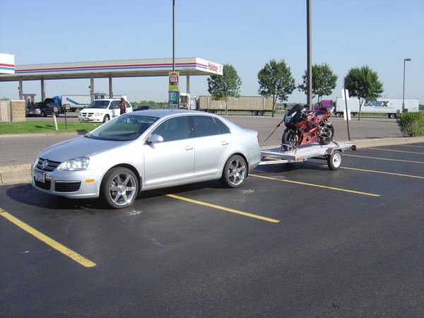

I pulled my trailer and bike without any issues. And I'm sure they upgraded the 09 with a better clutch and flywheel. So you shouldn't have any problems. The hardest part is to hook up the trailer lights. Good luck!

My Dad regularly tows a trailer with two motorcycles without any problems in the almost 100,000 miles he's put on the car. This is with a MkIV Golf TDI. And to add to that, a lot of the time towing the two bikes has also included three people and their luggage in the car. VWoA is lawsuit-weary, as are most U.S. companies; this is the main reason that VWoA discourages towing. Probably the reason they don't offer a factory-installed hitch in the U.S. too. R.O.W. Jetta/Golfs can be ordered with hitches from the factory and these cars are structurally no different than U.S. cars, nor do they have any modifications (other than wiring and other ancillaries) to accommodate towing.
