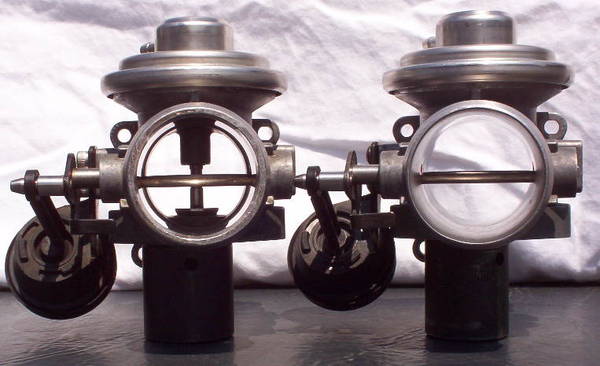

I like the racepipe concept but I don't want to give up the anti-studder emergency engine cut off feature.
I can't even find the ding-dang post where I showed my homemade stealth EGR with the "Fabtabulous Search Function" here...

Here are pics of what I did:
Stock EGR left, my version of the stealth racepipe on right
View looking down the bore of an early DG racepipe into my stealth racepipe below it for bore diameter comparison
