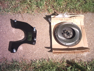

Here is the ACME kit, in case any of you were wondering what you get with the kit. It includes the adapter plate, ring washer, fasteners, and a Toyota flywheel machined to fit a VW engine.

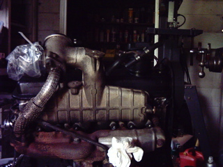

One slight problem for my intake routing is the 1Z's intake manifold:
It faces backward. Anyone have suggestions? I would like a much cleaner routing than some U-pipe. Are there intake manifolds from other models that would work?
e*clipse is offline   Reply With Quote
