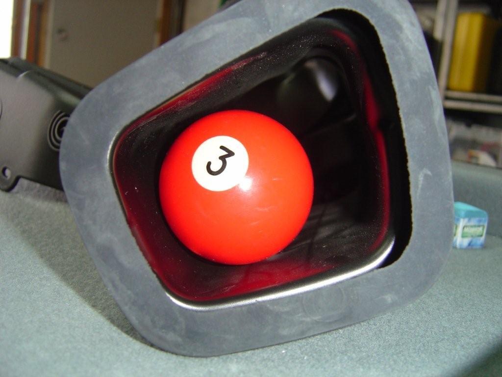

look at the 2 snorkles together. The r32 one is alot larger, and the increased diameter is the culprit for trimming.

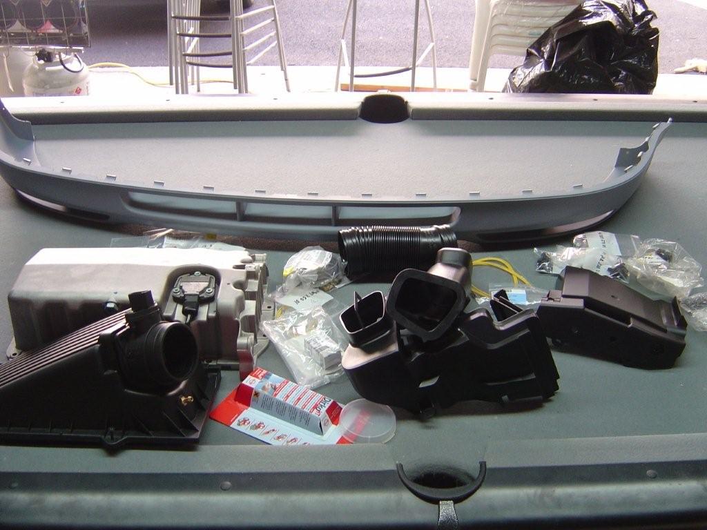

well the parts came in yesterday from impex, but I just find out that the stock north america version of the R32 airbox is too small for the big intake snorkel
so I call impex to see if I can get a airbox ASAP so I can install everything on the weekend
here is some pictures of the parts.
looks like I will be bussy on the weekend
and this one is very nice just to give you guys an idea of the size

I got the air box from vwvortex from a US spec R32, that hose on the picture is just part of my other upgrading project, that one goes from the MAF to the PD150 inlet pipe(OMI) hopefully I will be able to install the PD150 intake manifold and the BF SMIC all at once
