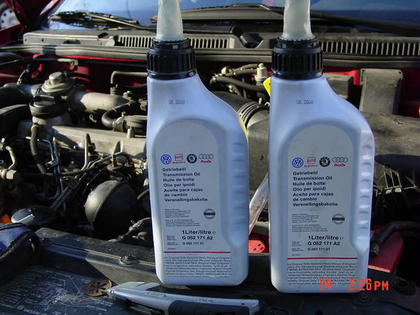

StevenM, I refilled with G052-911 (2002, 02J-EGR transmission), because I
saw it on some VW fluids charts that were released in the past couple of years ('04 or '05?),
that specified the 911 for the 02J transmission. I had previously refilled mine using Redline
MT90 and had eventually become a bit less-than-satisfied with the shifting.
I was able to get a couple of bottles of 911 from 1stvwparts.com, it wasn't cheap but I'm
sure the price is better than what the local VW dealer would charge. I think it's been about
3 months now, and my syncros seem to work more smoothly now. It took a couple of
months before the shifting really settled down, to fully improve. Larry

My wife's 04 PD New Beetle has over 12,000 miles on a fill of G 055 726 A2 and shifts very nicely with no grinding during this winter. We'll see how it holds out in the mid-summer heat. So far, so good.

So for a 2001 Jetta TDI 5 speed what is the best VW trans lub, the G52-171-A2 at some $30..0 a liter? For what it is worth 1st and reverse share the same synro., as down shifting can cause a bit of a grind if shifting at too fast a speed when doing so.
