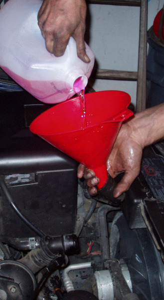

Remove the clamp on the upper radiator hose that leads from the radiator to the drivers side of the head. there is a union at that point that is convenient for adding coolant.
first fill the radiator:
then fill the engine:
then, reconnect the two ends of the hose leaving a small wedge through which air can escape, and hold it thusly while filling the resivoir like so:
Slowly, the coolant will fill the block and push air up through the hose. Once coolant rises up to the hose (you'll see it) reconnect the hoses fill the res to the proper level, and start the engine. this will ensure that the water pump is never run dry and is effectively faster than waiting for the engine to bleed itself while adding coolant to the res.
