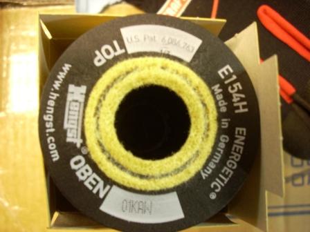

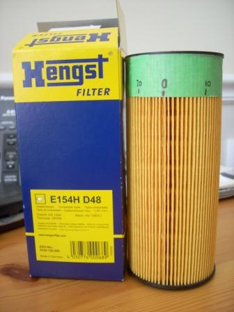

Do you mind delete the post that you screwed up pls.
Thx
Btw, that's the wrong OFC for that MY
Here's the correct OFC for that MY
The best OEM filter better than the OE and other OEM filters
(A)
No. pleats: 77
Micron rating: 10u
Hengst patented horizontal embossed supports/spacers to prevent filter element from bunching/collapsing.
U.S Patent
(A)
Rev. (A): Pictures added
