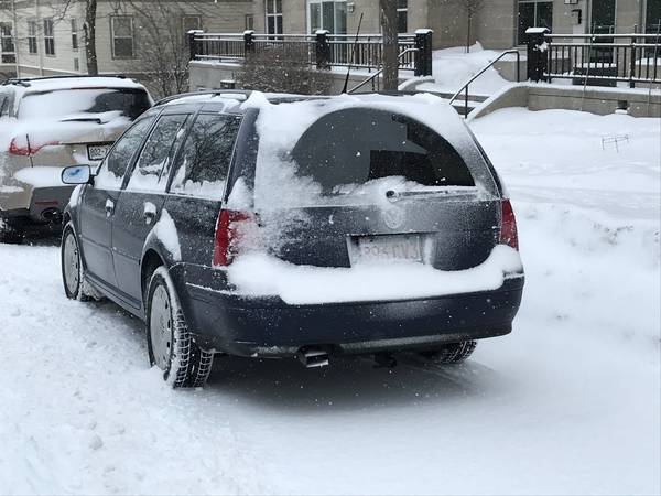

Thought I'd share this photo of my Wagon with Michelin X-Ice 3s on it from last Winter, in Madison WI.
Climbed the hill to the Capital on unplowed roads, no problem, except getting stuck behind a Civic with summer tires (and CA plates). Students!
